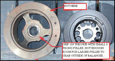

when i did mine, i kinda remember needing to grip with a 3 prong puller on the inside hub. i could not fit a puller down there large enough to grab the outside diameter and have room to allow the puller to work with the radiator. also, make sure when you pull the bolt out, you take the large washer out as well. as always, be careful not to press into the threads of the crank snout.
it came off pretty easy, once i got a good grip on it.
