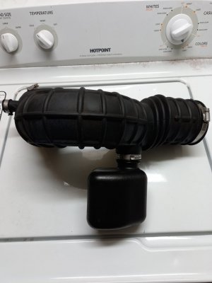

I have wondered about this for awhile. I have two stock intake tubes, one from an 05 without a resonator and one from an 07 with the resonator. From what little I could find online they are used to cancel sound waves reverberating from inside the intake manifold and could potentially add a little power due to smoother airflow? I can buy the sound wave canceling theory, but not the power adder theory.
Anybody got any real information on these things?

Agreed...I did find an article that talked about how these silencers can cause a power loss if removed, but I sincerely doubt that. I'm just wondering why some model years have them and some do not...I mean, what's the point?
Here's a segment of the article that talked about wave reversion:
"Adding an expansion chamber to the intake tube forces air coming back out of the engine to slow down to fill the cavity, thus expending a great deal of its energy and slowing the pressure wave reversion. This slowdown allows fresh air to flow toward the engine without fighting pressure reversion waves the entire way, thus aiding in cylinder filling. Since these pressure waves are essentially sound, giving them a place to expend their energy before exiting the air filter box ends up dampening the intake noise and quieting the engine. Thus, the resonator helps to make the engine paradoxically quieter and more powerful."

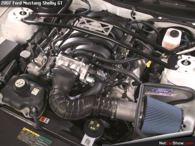

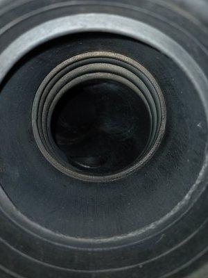

Yeah, that sound tube into the firewall seems pointless. The Shelby GT's used the stock intake tube with the Steeda CAI filter and heat shield instead of using Steeda's intake elbow. I'm wondering if there was any power lost, however minimal, by doing that. Looking into the stock intake tube reveals how it "steps down" an inch or so at that ribbed portion. I wonder if that ribbed portion, combined with the air resonator causes any serious air flow problems.

It isnt air coming back, it is soundwaves that cause a little restriction to airflow. It started appearing as OEMs keep looking for smaller and smaller gains to help with fuel economy and performance.

Has anyone ver had the stock intake tube setup with the FRPP (Steeda) CAI? Anyone with a Shelby GT use anything different than this stock setup?
