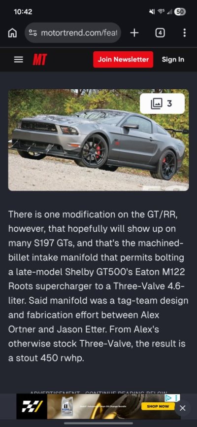

Just bought a 2010 gt/rr 4.6 with the gt500 blower on it says makes 450 wheel hp 52lb injectors wondering how much more bottom end could handle safely without going out
