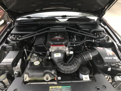

The Boss 302 strut brace actually 1st came out in 2010, used on the 2010 GT. It was used on the 2011 V6 cars, since it cleared the higher intake assy. It was used on the Boss 302 cars, and at that point was renamed the 'boss 302 stb'.
Once my M90 blower was installed on my 2010 GT, the boss 302 stb would not clear the roush CAI assy, so I sold it to a local buddy who owns a 2008 GT ( NA eng) and it clears everything, including hood, just fine.
I ended up using the steeda STB. We found 2 x steeda stbs that would clear the Roush M90..and still clear the hood..... but it just touched the rubber cai. When I installed the JBA LT's, I tossed the oem eng mounts and installed the steeda eng mounts, which allow for a stock eng height, or a 1/4" - 1/2" - 3/4" eng drop. We used the 1/4" eng drop option. Then the steeda stb clears the rubber cai just fine.
One of the fellows on the roush forum used a light + go-pro camera, + ruler, to measure the hood clearance, with hood shut. It worked good. He used one version of the steeda stb, and I used their other version, and both clear the M90 blower...and the 'power dome hood' used on the 10-12 cars. We let steeda know that 2 versions of their many stbs cleared the m90 and other blowers..and still cleared the hood, which is now reflected in their ads.
AM sells the polished boss 302 stb, which looks pretty good on 05-14 cars.

Yes. I had the FRPP Boss 302 brace on my 2010, and it uses 2 x slots at each end of the brace. Those 4 x bolts at each strut are only 26 ft lbs...dick. My problem with the slotted STB's is.... it's not solid, with 2 x slots at each end of the brace..and a paltry 26 ft lbs. One good smack, and they will shift on you.
I replaced it with the STEEDA STB. (boss 302 STB would not clear the roush M90 blower, so after blower installed, the boss 302 STB had to be removed). I also installed STEEDA HD adjustable strut mounts, which allow for camber adjustment. (then set the camber to -1.5 degs on each side).
The steeda STB uses all 4 x holes at each end. The steeda uses holes, NOT slots. The reason for the slots on the frpp STB's is simple, their length can't be adjusted. On the steeda STB, they use spherical's on each end, and the overall length of their STB can be adjusted, with lock nuts on the CM threaded ends....just like a turnbuckle. One end is reverse threaded ( just like a turnbuckle).... so the overall length adjustment is easy. With 4 x bolts, into 4 x snug fitting holes...at each end, it's bullet proof, it can't budge. The steeda STB is designed to work in conjunction with the steeda HD strut mounts.
Another advantage to the steeda stb is the transverse bolt can be loosened at both ends, and transverse bolt removed at say driver's side, and the STB can be swung up. I had to do this to gain clearance when I swapped out the oem twin 55 mm TB with the bigger FRPP twin 62mm TB. Also had to swing the STB up on driver's side to gain access to plug #8 (driver's side, closest to firewall).
