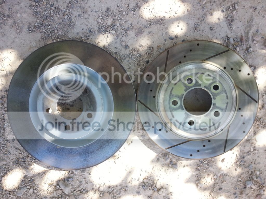

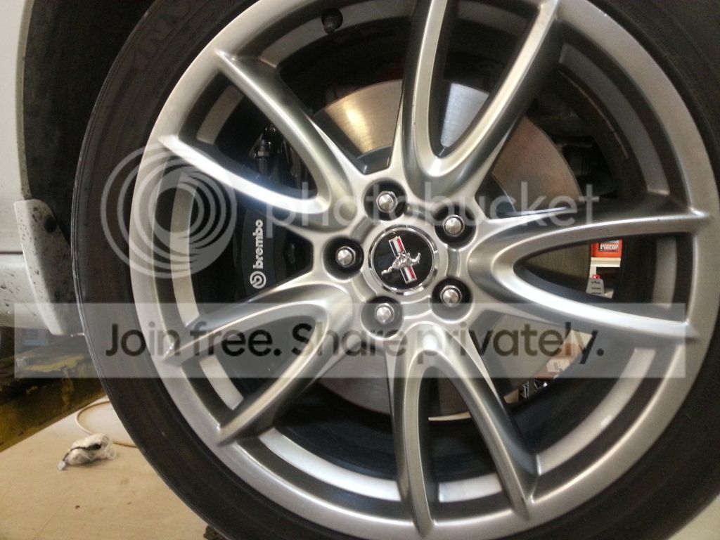

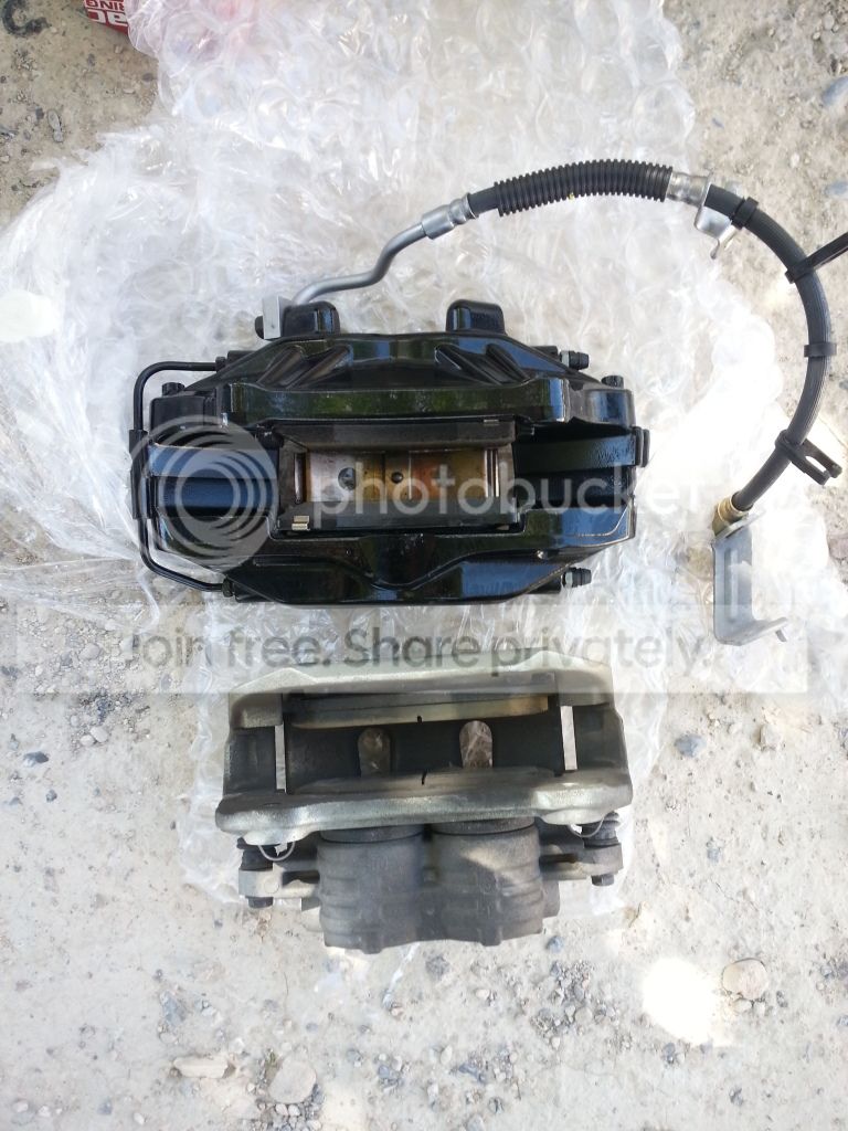

I have '08 GT500 14" brembo fronts and '13 GT500 13.8" rears. The brembos just with stock rotors/pads are a major difference over 05-10 GT brakes. The rears just look pretty. I'm sure they help but all the stopping power is in the front. I did all 4 corners for less than $1k. I would have done the 15" 6 piston brembos but the price was murder compared to '08 take-offs.
Edit: Both the front '08 and '13 rears are direct swaps. The rears require the '13 GT500 caliper bracket. Tasca can provide them if you only get your hands on the calipers/discs.

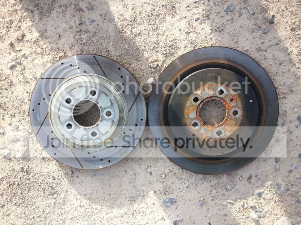

Alas I dont have any mounted pics of the rear or bracketry differences. It was all a painless swap. There is a catch to the rears I failed to mention. You'll have to remove the axel shafts in order to swap the caliper brackets lol. I was doing a gear swap at the time so it was perfect for me lol. As you can see, the rears dwarf the stock fronts in size. Just not as much surface area on the pad. I've seen some complain that no one makes a dual or quad piston caliper for the rears but honestly I dont think you want to unbalancd the brakes too much or you'll have stability issues. The single floating piston assists just fine.
The biggest difference I noticed so far is heat fade. The new setup leaves no trace of heat warping or streaking on the discs. The pedal is always there. I am a street car, but I do put the hammer to those brakes when it gets the lead foot applied. I do love the look of the black caliper on white car with brembo wheels!
