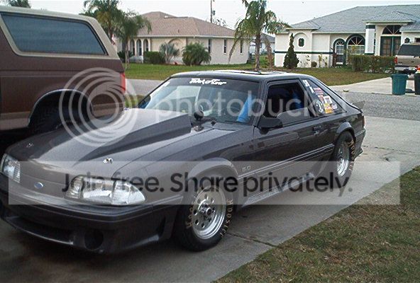

So here in Florida we're required to get a new license plate every so many years, I think every 5 years. In any case it was time for me to get a new tag for my stang so just for shits I checked if my old custom tag was still available and I couldn't believe it when I was told it was! Back in the 90's I had a 91' Mustang GT that ran 9.80's, and it had a custom tag "9 SEC GT", coincidentally both cars are silver. I eventually sold that car when I bought my first house back in 03, but the tag has been hanging on the wall in my garage ever since. Now that my 05 GT runs ET's that meet that criteria I went ahead and got that same tag again, I always joked about it when I first got my 05 but now that it really happened, it's kind of cool. Here's a pic of both tags together, of course the lower one that expired in 2001 was from my old car, above is the new one. Again, kind of cool for me.
And my 91 GT in action at a Fun Ford Weekend back around 2000:
Gotta get some pics like that of my 05 now lol
