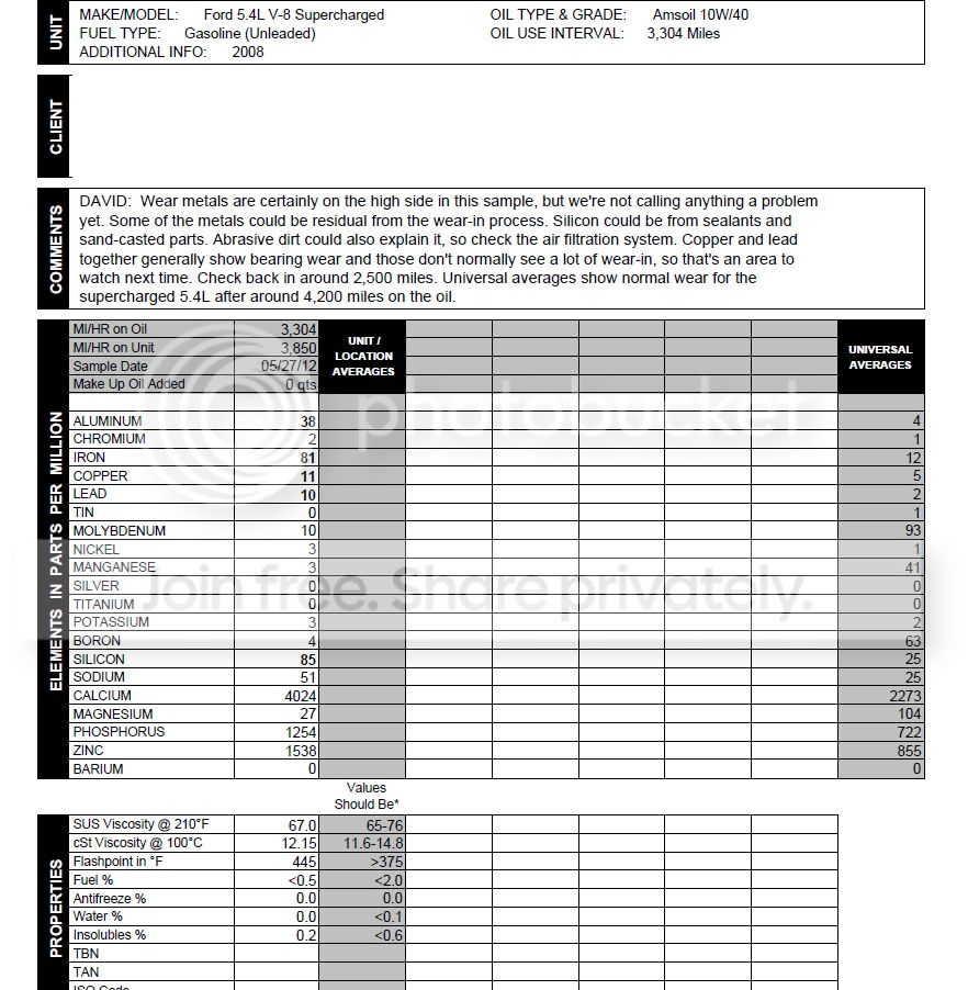

Bruce - SVTP has a long thread in the GT500 section with UOAs.
Here's mine from a while back.

What do you go by? Tbn, wear metals, viscosity? Does anyone post the bearing type and composition or is it just generic comparisons?
I'd imagine that the bearings would make a noticeable difference on the uoa. Stock bearings are designed to not deform or embed particles while performance bearings are supposed to catch particles and deform to be easier on the components. I'd imagine that performance bearing motors would have higher bearing wear metal counts since the bearings are designed with frequent inspection and replacement in mind. Along the same lines I'd guess that stock bearing motors would have more crank composition metals in the mix.
It's all just a guess on my part, thinking out loud more or less. Ring type would probably affect it too.
Looking at your uoa I'd guess that you have performance bearings and stainless rings due to the copper, lead, and iron in the samples. Once again just a guess.
I wonder why they compared your motor to a stock GT500 motor for averages? I suppose they had to compare it to something. IIRC you have a very tricked out motor that was built by L&M.

The goal was to look at TBN, viscosity break down and wear metals.
There was no analysis of different bearing types.
Not sure about the bearings, but IIRc yes stainless rings, the motor was also still pretty new on that UAO, maybe 3400 total miles and this was the first synth oil in the engine.
They didn't read my details about the motor so they compared to OEM. I have a revised one somewhere if u cared.
Yes, L&M short block, iron block, diamond pistons, total seal rings, Manley h beams and ARP studs

If you felt like posting it I would find it interesting to see the trends. I'd imagine that if I had a L&M motor I'd be watching it very close too. That's a sizeable investment.

Bruce - its just revised comments based on added info I reminded them of. It's not a second in a series. I forgot to take a sample on the second change as I was in a hurry. It's only on its third fill at this point. I typically put less than 2500 miles a year on it.
