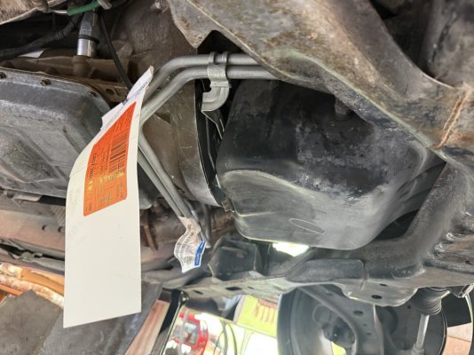

I did finally receive my cooler line some time ago and I will begin installing that today.

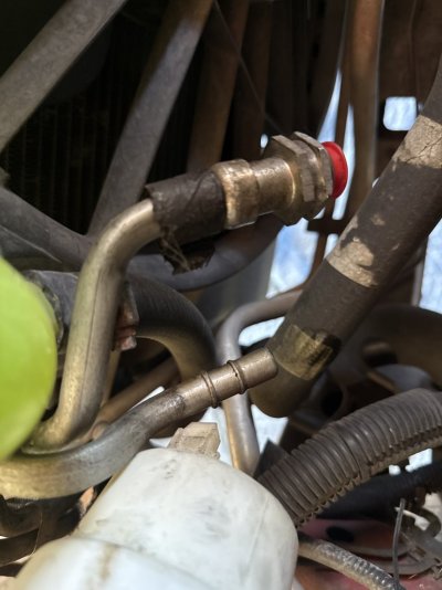

Give this part of the install 3 out of 10 stars. Straightforward but massive PITA. Routing the lines between the engine and crossmember while keeping them clocked a certain way as to not dig into the AC compressor and bind?
Screw this lmao
Pics aren’t great but I’ll take more when it’s finalized.

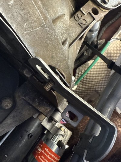

1. Secure lines with bolt to trans port Done
2. Get a bolt with a stud to secure the line to the bell housing Temp fix in place
3. Secure middle trans line mount to engine mount Need to cut locating tab to fit

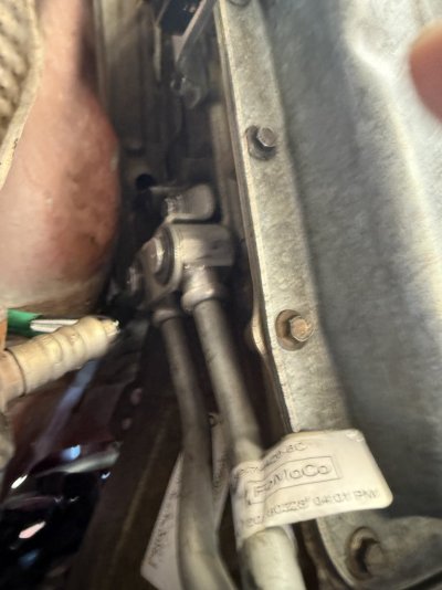

4. Click trans lines to cooler line Done
5. Secure that section to frame rail This is just sort of hanging out. Not sure on this yet.
