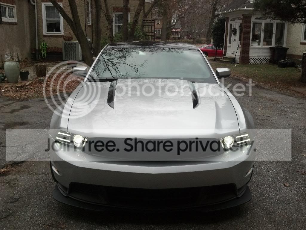

Put HIDs in, bragged to my friend... then cried a lil cause he had a point...
He sent only this as a reply
Stupid slowmarow owners; haters gonna hate.

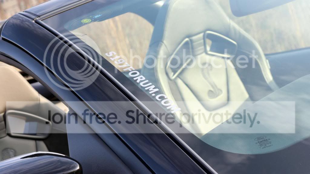

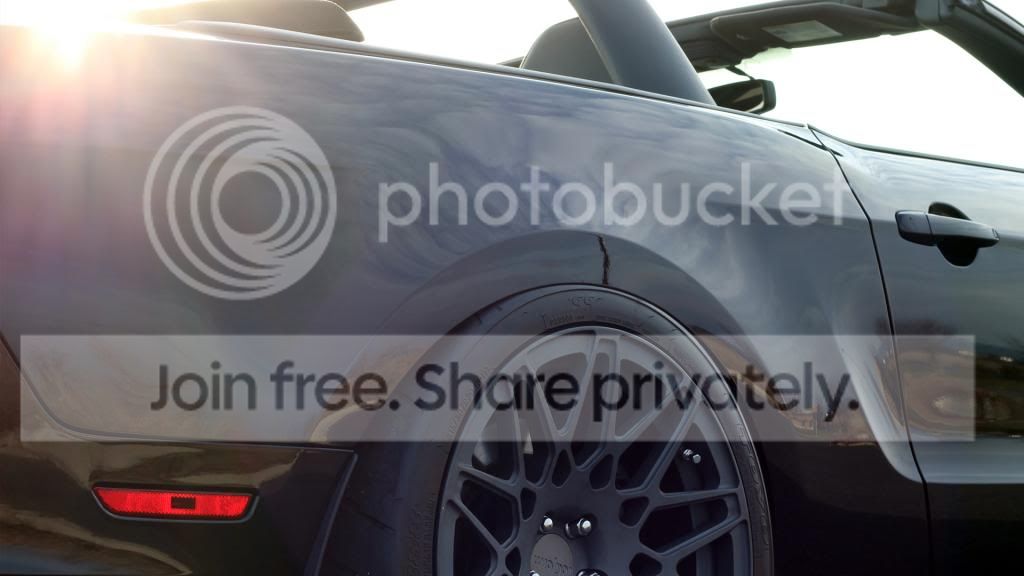

Wow... that is not even close at all lol. But will definitely look amazing once you get it fitted.
I'm confident it will look great after the body shop works on it a lot more.
That top looks way off. Have you contacted the company you got it from?
Yep, myself and the body shop have tried calling. We've been through so much shit with these guys beginning in June, and it's just a lost cause. I would have a very hard time recommending this product as the pictures speak for me.
There is suppose to be a gap in the rear, as the molding locks down on the lining around the convertible top and then that seals the water out, just not that huge. The gap is good because who wants the top rubbing against the paint after body movement/shifting. We are having a problem with the top locking down and lining up against the windshield frame and then at the same time locking around the molding on the convertible top. Most likely going to have to fab it to fit. They've already had to add fiberglass to the top to even out certain things. From the looks of it, they molded the top, sprayed a bunch of primer on it and then boxed it up with no QC.
