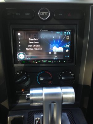

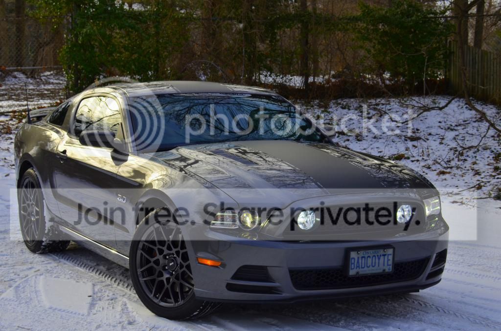

Got some vinyl I was playing with, not bad for the first time using it.
And a new head unit. Pioneer 5600
And back up camera

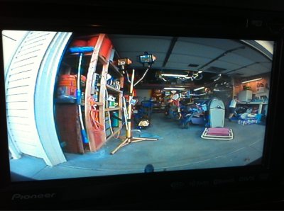

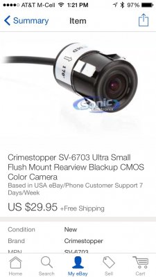

Thanks. How is the view and clarity with it? Can you snap a pick with it on? Do you like it?
Edit: I just noticed it was a blackup camera. I am looking for a backup camera. Lol
jlmotox
Sep 3, 2014
339
40
That's funny didn't notice "black up" camera before!

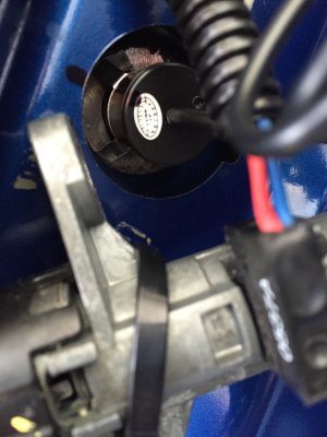

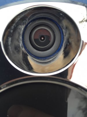

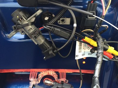

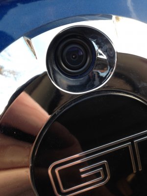

No write up just snapped a few pics of the install. Had to ream out a fender washer to slip over the camera up against the body of the car. Then just screwed the two pieces of the camera back together and it snugged up. The camera has one of those spring clip things to hold it in place. Took a little trial and error but came out good and I have had no issues since installing it a month ago.
The parking lines are at a funny angle and if I had to do it again I would have found a camera without them but it's not that big of a deal. Also the camera doesn't work as good as the pioneer one on my truck at night time but you can still see, just a little pixilated is all. Day time looks good but not as clear as the pioneer. But for a $30 cam it looks great!
Pioneer cam on my truck for reference...
