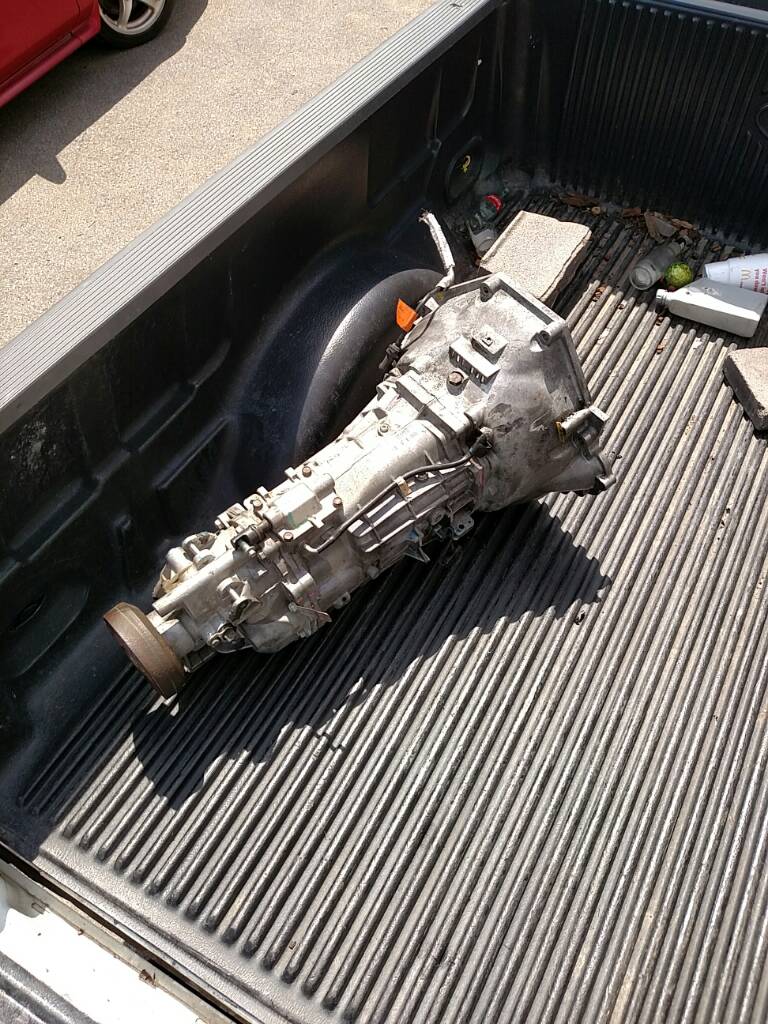

17k mile TR6060 purchased. Still need driveshaft and crossmember.

i am ryan
Jan 25, 2012
1,705
Nashville, TN
Local at a performance shop. I picked it up for $1200 dollars. I'll post more pictures of parts tomorrow!
You're shitting me. Which shop? Do they have more?
I have everything but the trans itself, the shifter handle and the clutch, but I have part numbers and there's easy availability on both of those last ones.

I'll ask and double check on Saturday.
I got it from Delk Performance over by Nashville Super Speedway. Their number is 615-453-2300 if you want to give them a call.
