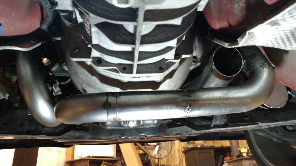

More pictures of the hot side coming along. I had to modify the passenger side pipe for the down pipe, hopefully tomorrow I will have the pipe from the merge to the turbo complete, then I'll finish the pipe that connects to the over the axle pipes.
Hopefully 4 fingers is enough clearance between the Bell housing and pipe. It's about 9/16"
Sent from my XT1254 using Tapatalk
