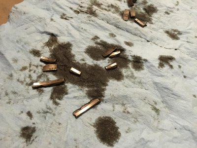

Same thing happened to me today. Had to open the diff to replace a weeping axle seal and noticed the metal pieces and broken housing. Bolts were loose and could be turned by hand. I took it apart and no internal damage so I plan to just tighten it back up and add some loctite.

Maybe I should loctite the bolts on mine before I install the diff.

I've been telling people this for years and for some reason nobody wants to listen. The Tru-trac is a stout piece and it is great at what it was designed to do, BUT helical gear differentials are not meant for drag racing You can build them stronger but they are inherently a poor design for street/strip action.

To be fair, this unit has been in the car since 2006 and has been down the drag strip >100 times. I am still gonna use it. Just needed to loctite the bolts and let her rip. There was no damage to the helical gears inside the diff.

Yeah loctite everything. And if you manage to still break it....another possible option is the 4 x pinion version tru-trac ( with the stronger housing)..... but the beefier version requires 33 spline axles. Still, either version...with loctite, at least won't have bolts backing off on you.
If you really wanted to go crazy, I suppose you could even use red loctite.
