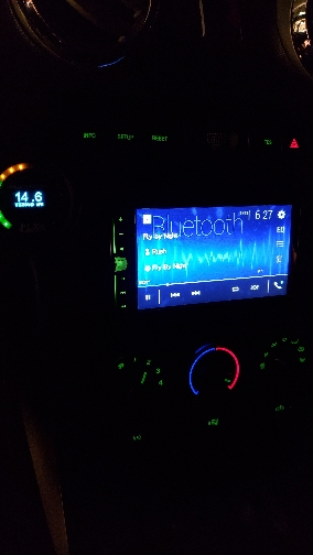

I did not tune my car but it is tuned with HP Tuners. My tuner would not do any performance tuning until I installed a wideband o2. The plx unit outputs a narrow band signal to keep the computer in the car happy and outputs a wide band signal to the gauge and to the HP Tuners dongle. Super easy install into one of the upstream o2 bungs.
