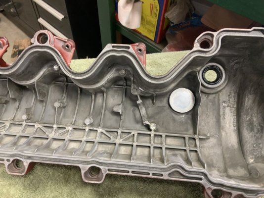

The pcv valve is built into the valve cover itself. I have a new set of valve covers that I'm getting ready to throw on after I do the oil pump, but I will post a couple of pics of where and how to remove the valve.

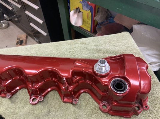

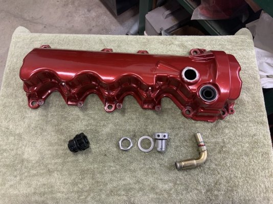

When I installed a different crank vent setup in my 2010 this 90* piece of tubing is what I removed. It has the check valve built into it and is hidden under a steel baffle. Sorry I don’t have a pick of the baffle plate but you can see where the rivets have been ground away inside the valve cover and what fittings I replaced it with.
