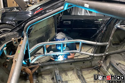

MORE ROLL CAGE WORK
The E46 cage kit we bought from Hanksville has been tweaked, changed, fitted, added to, and welded in place. All of the work has been after hours and it is 90% done. Normally a cage takes a couple of weeks, but doing it in 2 hour bursts once a week definitely drags things out, and it is easy to lose where you were the week before.
Myles has done most of the welding on the cage on work nights when he could make it, which were a bit scarce for a bit with a new baby at home. But the main cage parts are completed and both door bar sections were in place. The kit originally had an "X" on the passenger door but we changed that to the ladder style NASCAR tubing. As you can see in the pic above left, we are extending the verticals downward to the stock rocker structure - with load spreader pads. This makes the cage door structure REALLY strong, and more than makes up for any small weakness added with the "S" curve.
Our newest fabricator / technician / engineer is Zach (above right), who worked with Myles in FSAE years earlier. He joined us in November of last year. He has been here for all team car work nights since and has helped with some of the cage tube fitting and TIG welding. We added the FIA vertical tubes to the kit (see above left), like we always do.
Zach has jumped in with both feet on the team car, to both show his fab skills as well as to get a spot on the team - so he can drive this car! He has fitted the optional FIA bars and started on the optional roof bars.
Zach and Myles worked on the roof bar and the main hoop diagonal. Next was the upgrade from single foot protection bars to the triangular tubes we wanted...
Zach made this structure above on the fab bench to be able to cut / cop / TIG weld these tubes together. This trick allowed him to weld the junction and "foot" to the end of the triangle, then he only had to stand on his head to weld the two legs to the main down bar and the foot to the floor.

FINAL CAGE WORK
This was a last push of work nights to get the cage 100% wrapped up, then to add some cage-to-chassis plates, remove the last bits of metal inside we don't need, add window nets and mounts, as well as a panel to house the external fire bottle pull and battery kill. The goal was to get the car to the painter before the end of March, which we did.
Over several Team Car work nights Zach and Myles knocked out the final welding work, added a few small tubes, then finish welded the rear shock tower reinforcement plates.
