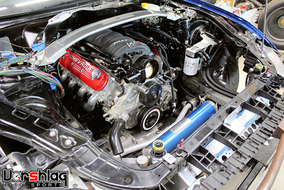

ACCUSUMP INSTALL
As I have mentioned before, this Phase 1 HPR built 383" LS6 engine is using a WET SUMP oiling system. Some like to think that only DRY SUMP oiling systems should ever be used on a road course, but of course that is not true. It is usually based on some legit engine failures heard about second hand without all of the facts. We've built too many wet sump LS engines to believe this. The key to keeping a wet sump LS engine alive at very high lateral and braking loads (road course use with R-comps or better) is good oil pan baffling and some sort of oil pressure accumulator. I also like to run LS engines +1 quart over "full", which burns oil at a faster rate and adds some windage, but I've never lost a wet sump LS engine when run this way.
I have also experienced one LS engine failure on track - the LS E36 above at ECR in 2008 on 315mm Hoosiers, BEFORE we added a 3 quart Accusump and baffled/trap door oil pan. It had a junkyard LS6 with unknown number of miles and I somehow let the engine get THREE quarts low on oil (long story - I was driving 3 cars that day and helping out 2 other drivers, so I was a bit distracted). This super low oil level caused a loss of oil pressure while cornering and the rod bearings began making racket, so I pulled in and it was the end of that day (but it wasn't catastrophe failure - that engine was rebuilt later for use on another build).
We replaced that with a more powerful LS2 based 7.0L and added the Accusump and Improved Racing pan baffle kit (plus an oil coolers) and never had an issue with it again. and we beat on that thing, making 500 whp. We have already covered the trap door oil pan on this build (and the work we needed to do to make it fit correctly) so the only missing link now is an accumulator.
So we found the right Accusump, and this monster is 24" long, which limits the number of places you can mount it - severely! I am all about the electronic triggering, so it doesn't need to be sitting next to me like in the E36 LS build, above. Having a hot volume of engine oil in the cabin is always a bit sketchy, in any case. Jason, Brad and I looked and there was SO much room in front of the engine that we snuck it in at the base of the radiator, ahead of the meaty Whiteline swaybar. Brad start making bracket templates...
The left side (driver's side) bracket was relatively straightforward to make. Brad was able to find an existing threaded hole in the frame rail and then tied into both mounting holes for the swaybar, with a place to mount the included Canton clamp bracket.
The right side was a bit trickier, and required one Rivnut be added to the lower subframe, as shown.
That bracket had a different orientation than the other side, but the cylindrical Accusump doesn't care. That bracket bolted to the swaybar and the subframe, as shown above.
This setup is much more rigid than I thought it could be, just showing how mounting on two planes for each bracket could stiffen up the assembly. Nice low mounting moves the CG lower, but its more forward than we had hoped - but again, not many places to mount something 24" wide like this.

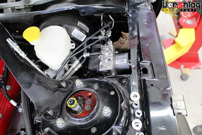

FUEL HARD LINES
We started on the fuel system already with the fuel rails, and we will tackle the trunk / fuel tank / surge tank lines in another task. For now we needed to run the big lines from the front to back.
For various reasons I prefer to do the long runs of fuel lines with aluminum hard lines. I like running them UNDER the car but ABOVE the bottom of the lowest parts of the car (frame rails) so they cannot get snagged and ripped away in an off track incident. It isn't the ONLY way to run fuel lines, it is just the safest way that we have adopted on many cars. The OEMs also tend to run hard lines for long fuel runs - either metal or plastic. Of course plastic has so many downsides...
This aluminum tubing is bought in a roll, then straightened, then bent to fit the long runs, and finally flared at the ends for the fittings. We always build these to terminate and transition to flexible lines at bulkhead panels at both ends. Above are the two bulkhead panels built for the rear (top left) and at the front engine bay (top right).
The rear bulkhead on our LS550 is placed at a convenient spot near the fuel tank/trunk area, above left. For this build we chose larger than normal hard line sizes: the feed line is a -10 or 5/8" diameter, and the return is a -8 or 1/2" line. Normally on a ~500 whp engine like we have in Phase 1 we'd use a -8 and -6 lines, so we're up TWO sizes. This is to build for a Phase 2 engine, and this fuel system could support about 1200 hp.
continued below
Vorshlag-Fair
Official Site Vendor
Nov 12, 2010
1,592
116
Dallas, TX
continued from above
In the engine bay we have a bulkhead connect panel in the back left corner of the engine bay (above left), right under the brake booster. I missed getting that picture after Doug installed it from the inside, and it is really hard to see now (above right) because there's a lot going on back here. We have three fuel lines (the main feed, the return, and a regulated line to the fuel rail), the Aeromotive fuel pressure regulator, and giant -12 oil lines snake around all of this as well. As big as this engine bay is, I really had trouble laying out a "clean" placement of everything on this side. But for now, this will do.

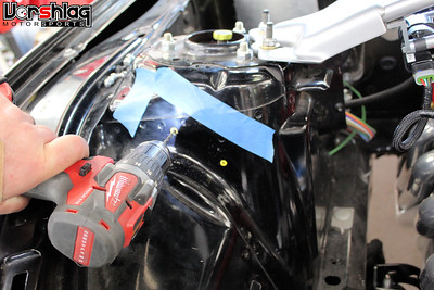

Last up was the grill openings that "feed" the airbox cold air from outside, as well as the radiator and oil cooler. The factory 2018 GT upper and lower grills have a lot of areas blocked off. The OEMs do this to reduce drag and eek out a fraction of one more MPG, after wind tunnel time spent with engineers, thermal testing, etc. Since we're adding more power than the regular 5.0L would have, so we need to open up things...
We have used this trick in the past to "uncover" grill openings when it is a cast plastic part with these decorative hexagon shapes on the front. A 36 grit sandpaper disc is used to remove the inner layer of plastic and the hexagons remain - so it still looks factory, but allows much more airflow.
This was done on the front left corner that feeds the air filter box, as shown above. This mod added 5x as much surface area for air to get to our uniquely positioned filter inlet & airbox, and will have a small "ram air" effect at speed once we seal off the inner wall of the airbox.
Since we have a rolled radiator and a low mounted oil cooler, the upper grill isn't feeding much (and we might block it off on the back side. To feed the lower opening Brad also opened up the lower grill area as well, which was about half closed off as well. This should help with cooling airflow to these two low mounted heat exchangers.

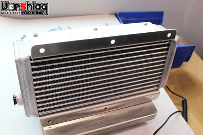

OIL COOLER ADDED AND PLUMBED
Almost every track car we have ever built needed a supplemental oil cooler or oil cooler upgrade. Our 2018 Mustang GT (below left) made 485 whp with the Gen 3 Coyote and headers, and the Mishimoto oil cooler we modified and added made the oil temps cooler. This car recently came back to us from the new owner, who complained of high oil temps (possibly a differing driving style, shift points, geographic location, etc) and we just installed a larger, thicker, and more efficient Derale stacked plate oil cooler (below right) on that car.
Our LS550 is going to make a little more power than that in Phase 1, so we're installing one of the largest Derale 10000 series "stacked plate" coolers - with room for one more right next to it for the future Phase 2 engine.
We actually bought this Derale cooler for my wife's LS swapped 86, but that has been stuck in our lobby for a while awaiting its turn in the shop for completion, so we "acquired" it from her parts shelf and got to work mounting it on the LS550. We also ordered up a Derale part number 50022 mounting rail kit for Derale stacked plate coolers (above right), which we have used on a few in-house track car builds.
Brad made some simple brackets to attach these Derale rails to the car's main frame horns at the top and to the lower subframe / radiator support at the bottom (see above right). Our goal was to keep the cooler mounted low to get the airflow from the lower grill, and place it close to but not touching the aluminum radiator - so air cannot bypass around the Derale oil cooler (it sits 3/4" away from the radiator).
The same day this cooler was mounted, Brad began plumbing the rest of the engine oil system - from the pan to the remote Improved Racing oil cooler with thermostatic bypass and on to the Derale oil cooler. Again, when the oil is below 185F it will bypass the oil cooler. When it warms above that, then oil will go from the filter to the cooler then return to the engine.
We ran all of the oil lines in -12 AN sized Fragola braided lines. We have seen shops use smaller lines on engines like this but then they also tend to chase low oil pressure problems. On the 2018 GT we used -10 lines because that is what the Mishi oil cooler kit utilized, but on a higher RPM race engine you pretty much always use -12 AN lines or larger (-16 AN is also common).
The lower brackets looked a little "springy" to me so in February of '22 I asked Doug go back and reinforce these parts. Now the cooler is less likely to bounce on the lower mounts.
This sized cooler has worked on similar power levels for us in the past, and as you can see above that adding another identical cooler right next to this one will be pretty easy and take little effort. That would effectively double the oil cooling, which would be perfect if we double the power.

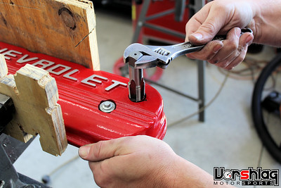

REMOTE COIL MOUNTING
So I never liked the look of the 8 individual coils mounted to the factory LS valve covers. While it is an elegant and simple solution, and makes for easy spark plug wire runs, it is ugly. I'm vain and for this build needed something flashier. Moving the coils away from the heat of the headers was another secondary reason for "remote mounting" the coils. I also had a pair of these showy "CHEVROLET" valve covers, which I had custom powder coated in red with exposed lettering, that I really didn't want to cover up.

I spent way too much time mulling over the ignition coil locations, looking at show car and race car remote coil solutions. In the end these simple ICT billet mounts were "the most right" answer. And the big strut tower cross brace we had on the car was quite a bit further away from header heat, and looked like a nice mounting structure. I honestly wanted the coils further back and/or hidden completely, but the engine bay was starting to get tighter as we added more bits and pieces.
Doug tackled this installation and it went quickly - we mocked up the locations with measurements and symmetry, then he removed the hollow aluminum Ford Racing cross brace from the car. Doug marked and drilled the holes for M6 rivnuts, which made for a clean mounting arrangement.
This coil location exposes the valve covers and somewhat hides the coils, while keeping them a bit further from the heat of the exhaust headers. The Holley Dominator wiring has since been plugged in for the coils and tucked out of the way, with custom spark plug wires being built later this week.

MOTORSPORTS HEATER BOX
We race 12 months out of 12 here in Texas, and our winters can and do get below freezing. I have been to a number of January events where there was frost or fog on the windshield so we always like to add a defroster to all of our race cars. Having a working heater will also help in Optima events - which this car will do.
The first step to getting the heater core mounted was removing the dash, which needs the doors off to access the mounting bolts - shown above left. And this step led to the carbon doors going on, shown below!
The dash in this 2015 GT was only loosely installed, as it was a parts car quickly thrown together from leftovers before I bought it. Brad worked on fitting the dash better for the reinstall by adjusting these screw-in width adjusters, so it won't be flopping around. With the 22.5 pound OEM "HVAC" box out of the way, the new 7.4 pound motorsports heater core looks tiny sitting on the trans tunnel.
We have used this 7.4 pound heater core from Summit Racing on many race cars for the past decade. It has a heater core inside, two outlets which fit up to 3" hoses, and a variable speed fan on the back side. All self contained and easy to mount - but we never use the included "universal" mounting brackets.
Doug made up a simple aluminum sheet metal bracket which bolts to the tunnel (into rivnuts), placing the core far enough behind the dash's center stack portion, but still with enough room to access the heater hose nipples. I am a fanatic about firewall integrity and insist on bulkhead connectors for all plumbing and virtually all wiring pass-thrus for any firewall.
The heater hoses going to and from the heater core here were another place for these stainless bulkheads. These have nipples made for simple hose clamps and hoses, which are fine for low pressure cooling systems (16 psi) we tend to run. For a higher pressure fluid system we would be using AN fittings. The placement for these two were planned out along with the reservoir mounting spot and several other items in that area. I will show the final plumbing in the heater hose section below.

PETERSON OIL CATCH CAN & PLUMBING
Any car driven on a road course with an internal combustion engine should have an oil/air separator and catch can system. This prevents excessive crank case pressure from spewing oil out of the engine - either into a sealed EGR system or an open vented system, like on this car. I explain the difference between these two types of oil catch can systems in this recent post on our narrow body C6 - and it applies here.
Since this going to be more "Race car" than "Daily driver", we went with a vented oil catch can from Peterson oil systems. This has an internal filter to catch the liquid oil droplets and keep them from spewing out of the vent at the top of the can (again, see the post on the C6 section showing this). This Peterson can is our "go to" option for race cars that have a wet sump oiling system.
To feed the crankcase pressure to this air/oil separator we needed to run big vent lines from both valve covers. The cast aluminum, tall, red "CHEVROLET" valve covers both got holes drilled to have 1/2" NPT fittings threaded. the Fragola fittings were then shortened on the bottom side so that they do not come close to the rocker arms - that would be bad!
That leaves two big -12 AN fittings on the back of both valve covers, which Doug then plumbed to the two inlet ports on the Peterson can with AN12 Fragola hoses.
This works our for a clean, dual fed, crank case vent system with an oil / air separator inside the can. There is a drain port at the bottom of the can which has a petcock, that Doug then plumbed with a hose down inside the RF fender area. After every track event we can open this petcock and drain the captured oil to keep the can from filling up. Again - every road raced car should have some sort of oil / air separators with a catch can and drain.
S197 ABS INSTALL
Wait, what?! We already had an S550 ABS system installed on this car earlier! Alas, since we installed a salvage yard sourced S550 ABS unit, as well as a master cylinder and lines from Ford, we have learned of CAN challenges with S550 ABS swaps. Namely - that is has never been done, and involves a LOT more CAN signals from OEM computers we don't have in this car. That is more work than we are ready to tackle at the moment.
The S550 ABS unit has been removed, boxed up, and shelved - for now. Instead of tilting that windmill, we instead decided to go with an ABS unit we know well and have successfully swapped into other chassis - the S197 ABS unit from a 2011-14 Mustang GT. These exist in the tens of thousands in salvage yards, after countless Mustangs have unsuccessful avoided ditches, trees, curbs and crowds.
Now I personally have driven 100s of laps in S197 Mustangs with this late 2011-14 ABS, both on track as well as autocross. And we know that we can make this work without ANY of the stock CAN inputs, if we use the right Ford Racing ABS computer, which we do have on hand for this car. But using a factory manual & wiring diagrams, plus a donor car we have on site (2011 Mustang chassis), we want to test some theories on an S197 ABS swap without using the expensive and rare Ford Racing computer (it is out of production and getting very hard to source!)
Again, if I thought there was a way to make the S550 ABS unit work with this completely CAN-free car, we would. This will save us months of frustration - and help prove out some alternatives for other chassis we want to ABS swap. We've done a number of Mk60 ABS swaps and one S197 swap, so this is just another option. We reached out to our friend Paul at Tri-State Auto to source a 2011-14 ABS brick + mount + harness connector, and he delivered once again. The image above right shows the S197 ABS next to the S550 - similar in many ways but still very different.
Now to be on the safe side we went ahead and mounted the S197 ABS unit at the same angle as Ford did (see above left). This will be oriented the same way and tilted at the same 18 deg angle. The S550 ABS unit (above right) sits "straight up", without this tilt. We planned to place the S197 unit in the same basic spot as the S550 unit, but with the 18 deg tilt.
I labeled the two units with the outputs of both units on the "top, but the input ports are on different planes. Doug then mocked up the S197 ABS brick in the engine bay with the 18 deg tilt, and it looks accessible. Now it was time to make the bracket and then the lines.
Doug took the S197 ABS brick's mounting bracket (which was bent / damaged) and flattened it out, then made a template of that. This was then modified to fit the S550 chassis. It took two versions to get everything aligned correctly but the CNC plasma table made this go quickly.
The second version was bent up to fit the ABS brick and the S550 chassis mounting points, then the S197 isolators were added to the big holes cut to accept those. This allows the hydraulic unit to not vibrate as it cycles, which can throw off the actuation. We do this isolation mounting on every ABS swap.
We received the S197 unit from salvage with the correct hard line fittings (tube nuts) and the harness with a "tail" of wires we can re-use. That proved to be critical, as the S197 and S550 used different end fitting flare angles on the M10 and M12 ends. Why? Nobody knows! You can see our S197 adapter bracket bolted into the S550, above right.
Doug caught this tube nut fitting difference - it was all lining up perfectly, but now we had to cut each hard line in the car, swap in the S197 tube nut, then re-flare each end. A bit cumbersome with the hard lines still in the car, but Doug used this pneumatic flaring tool to get them all swapped.
continued below
Vorshlag-Fair
Nov 12, 2010
1,592
116
Dallas, TX
Even the two "flex" feed lines from the master cylinder to the ABS brick (which we purchased new for an S550) had to be cut for new S197 tube nuts (both were the larger M12 sizes) and re-flared. This wrapped up the plumbing for the brake system and the ABS brick mounting. Next time we will show the wiring for the speed sensors as well as the additional yaw sensor needed to (hopefully) make this work with the OEM ABS computer.
We want to test the OEM S197 ABS system on this car (to verify that it can work on ABS swapped cars), then we will have found a good, low cost ABS system we can swap onto any car without needing the rare and expensive Ford Racing ABS computer. After we get this tested we can then swap in the Ford Racing ABS computer and retest the brakes with that setup - to see how much better it stops, if any.

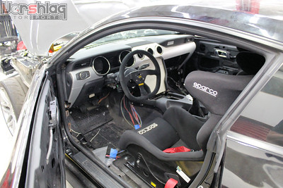

NRG QUICK RELEASE + STEERING WHEEL
Up until this point we still had the original steering wheel installed, but that was never going to see any track use. To get from the stock wheel to the Momo model 88 wheel with a steering wheel Quick Release AND a working horn, took a bit of work.
I wanted a smaller steering wheel on at this point in the build so we could size and place the digital dash unit. Of course if we are adding an aftermarket steering wheel, and not hoping to keep any airbag or wheel mounted buttons working, we want to add a Quick Release steering wheel hub (aka: "QR").
Normally we would reach into the Sparco/Lifeline catalog and pick one of their beautiful units - but I did want a working horn, and a thinner QR unit. Having driven recently with an NRG branded QR, I rolled the dice and bought the hub adapter and "thin" style QR from them. Unlike other import QR hubs, this brand has an SFI rated unit - so its better than most.
To make the horn button work we needed a clock spring, which was missing along with virtually all wiring on this salvage car. So we went to eBay and bought one for $34, $100 cheaper than the Ford supplied unit. Hey, its just for a horn.
The NRG branded QR hub had a 2 wire pass-thru, which Sparco/Lifeline charge a large up-charge to get. The listing they had for the adapter hub showed "2005-up", but I worried that the 2015-2023 Mustang S550 unit would be different. And it was. I will show below what it took to make their hub adapter fit the S550 with a working clock spring, so we could have a working horn.
Once we bought the clock spring we had to chase down the steering wheel sub-harness, to connect to the wiring of the clock spring once it was mounted. We found that on eBay and only needed one connector - to connect two wires into the clock spring.
This is where the "2005-up" adapter hub from NRG needed major modifications. First up, Doug had to mark and drill the two holes in the hub to align with the clock spring pins, otherwise the tunable clock sprung unit would never rotate. Next up a pocket had to be machined into the back side of the hub to clear the clock spring wiring connector...
You can see the connector on the clock spring, above left. This has to fit within the pocket on the back of the hub adapter. Doug also added a hole for the wiring connector that stays within the hub and sends the wires to the horn button on the Momo wheel.
Details of the steering wheel harness that normally connects to the stock steering wheel, which has a lot of pins for a lot of circuits. We only need two pins for the horn, and those are being connected, above right.
The automotive horn circuit is very simple... it is just a momentary button that closes the circuit, that then triggers a relay that runs the horn. And yes, we use horns on race cars - this has saved me from being backed into in grid TWICE. Thousands of dollars of bodywork damage avoided by a quick "HONK!". The two pass-through contacts for the horn circuit are seen on the open QR hub, above right. again, most QR hubs do NOT have wiring pass-thrus.

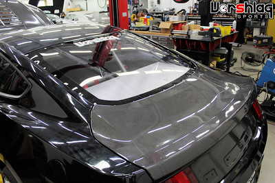

LEXAN BACK WINDOW INSTALL
Thinking we would lose some weight by ditching the rear glass, I decided to go with a Lexan rear window a while ago. We got these from a UK company called Plastics4Performance, and they always produce great fitting Lexan that is pre-cut, curved to shape and pre-painted borders. Even with overseas shipping from the UK their parts cost less than domestic suppliers. We love using P4P whenever we can!
We had Titan Glass (a windshield company) back in the shop in June 2021 and had them pull the rear window, which they got out cleanly and in one piece. Modern glued in windshield and rear glass can be tricky to remove, and tempered side and rear glass literally explodes if you break it - so we let the pros handle removal and reinstallation most times.
Fast forward to Spring 2022 and it was time to get the Lexan installed. Doug mocked these up in the empty back window channel and they fit perfectly. They looked pretty close on the quarter windows as well, but I decided to hold off on installing these for now - seeing how little weight these actually remove.
As you can see the rear Lexan window is only 9 pounds lighter than the stock glass window. Hmm, not much weight loss, which is why I held off on the quarter windows. Remember: glass windows are VERY hard and scratch resistant, but Lexan is the opposite of that.
Doug cleaned out the stock weather strip material and (after the steps below) installed the 1" wide x 1/8" thick, adhesive backed weather strip material we purchased for this install.
Dozens of M4 rivnuts were installed along the perimeter to mount this window in place. We like to use these Tinnerman countersunk stainless steel washers to make the M4 countersunk bolts fit flush to the surface of this window. Drilling the Lexan is easy with a sharp drill bit, and we leave the outer (blue) film on until after all holes are drilled and counter sunk.
continued below
Vorshlag-Fair
Nov 12, 2010
1,592
116
Dallas, TX
The final Lexan install looks great, but again, all of this work only dropped 9 pounds. We still like these removable Lexan windows for the rear, as they can be unbolted without breaking the glass or needing special cutting tools, which we needed to attack the rear deck lightening and the trunk bulkhead install. Also, when a Lexan window breaks it doesn't shatter, so that's a plus for a race car.

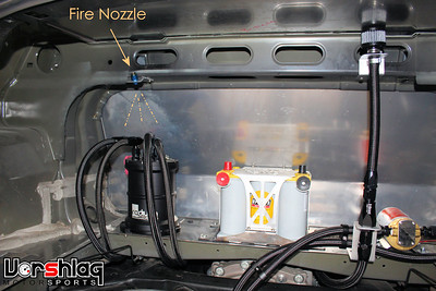

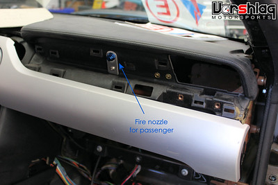

FULL FIRE SYSTEM ADDED
I was going to add a full fire suppression system on this car later, to keep the "initial race weight" down (trying to win a bet with a buddy!), but I just don't like taking chances with fire - so a Lifeline Zero 2000 4.0 liter AFFF Fire Suppression System was added before the car ever turned a tire in anger. With as many plumbing and wiring changes made here, this is just smart insurance. The further from stock your race car gets the more likely you will need to use a fire system. We also added one of these to our old red 2018 GT for the next owner in early 2021 - and some of those images are shown below.
This is the exact same "aqueous foam" system going into our black 2015 GT, and on the red 2018 we mounted the bottle in the trunk, the nozzles in the cabin the same as our '15, and even the engine bay nozzles we well. But we are making some small changes from this point forward. After talking to a fellow racer at PRI in December of 2021 - who had suffered a horrific race car fire fire - we used some improvements based on what he saw. For one, we are changing how we will install the two fire pulls in all cars from here on out. I will pull this section out and make that its own forum post in our "Safety" section, too.
On the red 2018 GT above, which is still very much a street driven car and track car, we put the two fire system "pulls" in the same places we always used to - one below the headlight switch on the driver's left, and a secondary pull in the center console within reach of the driver. Let's call this "driver-centric placement".
That was a common way to place fire pulls for a fire system for a decade of more. But in Mark Patronis' Corvette crash and subsequent fire (his helmet above should tell you a lot), the right side of his car was buried in a tree - which was where his only externally accessible fire pull was located. The other pull was in the middle of the car - which was on fire - but he was knocked unconscious. So nobody could get to either fire system pulls, and precious seconds were lost before the fire truck could arrive.
As you will see below on our 2015 GT, we have started placing both pulls with an emphasis on "corner worker access", with a strapped in driver's easy access as a secondary concern. Hey, you can always grab the fire pull on your way out of the car. Hopefully we can all learn and progress over time to avoid these situations.
After Jason and I went all over the 2015 GT, and the very crowded trunk area, we found a place to mount the Lifeline 4 liter fire bottle, it came down to the back seat area. Instead of mounting this above the factory fuel tank covers, it looked like this could fit right behind the driver's seat and still allow access to the fuel tank cover. Doug made the domed aluminum sheet metal cover for this side of the saddle tank at the same time as he made this fire bottle bracket, which itself bolted to the rear "cross beam" normally under the back seat.
The next step in any fire system install is to locate the best places to mount the nozzles that discharge the fire suppressant. Aluminum sheet metal brackets are mounted and the nozzles are aimed at the common fire source locations - a pair of nozzles are aimed at the two fuel rails, where the fuel injectors live. These are also near the exhaust headers, a high source of heat. In the trunk we mounted a nozzle above the remote fuel surge tank, which houses the two fuel pumps and many fittings for the fuel system.
Inside the passenger cabin we have two nozzles. One points to the passenger's lap and the second points at the driver's lap. These areas are eventually covered in plastic trim, but with holes to allow the nozzles free aim.
With the nozzles all placed it was time to plumb them from the main tank. The system comes with plenty of aluminum tubing, T fittings, and is relatively easy to connect. These are cut with a tubing cutter then pressed into the quick connect fittings. To remove them, a tool is used to release the locking clamps internally.
From the bottle one line goes into the trunk to feed the nozzle there, then another goes forward to feed the cabin nozzles and engine bay nozzles. These were routed to fit underneath the center console, with notches in the plastics to fit these without crimping the lines.
With all of the nozzles plumbed, the final step is mounting the fire system PULL handles. We used to put one in the center console by the driver and another at the driver's side front window front corner - but after hearing about a crash where one side was buried in a tree, we have opted to put one on each side, reachable from the outside but also within reach of the driver (on the left side). You can see the first pull on the above right image, where one of the aluminum panels Doug built fits in place of the outermost air vents. A custom machined bung is attached to this flat panel to point the pull handle at an angle for easy access by a corner worker from the outside.
This type of placement of the two fire pulls allows a corner worker from either side of the car to reach and pull the fire suppression, even if the cabin is engulfed in flames or one side is buried into a barrier or another car. Now there are other safety measures you can take - like an automated (170F) release, which could help a driver who is unconscious to be safe before a corner worker can get there. I will cover this and more in that separate fire system install forum post.

Brad began reassembly of the front end by installing both front fenders, which had both been on the car so they fit up nicely. Next it was time to install the newly painted black nose.
The bumper cover plastics are flimsy but when the grills and lower lip are installed it all "firms up" and takes shape. This is a bit of a fiddly process and it takes 4 hands to get everything popped into place, but once assembled the nose went onto the car - held on at the top by the radiator support and on the sides by the fenders. The headlight assemblies went in last.
The ride heights on the MCS remote double struts were setup for the 3650 lb weight of the 2018 GT, but with 600 fewer pounds on this car the front ride height needed a big adjustment. Brad lowered the lower collars on the struts and got the front end to drop another inch, now with "normal" fender gaps up front.
