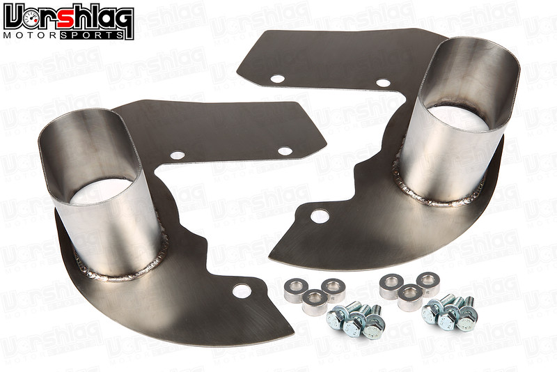

While we had the car apart we went ahead and made a major revision and production batch of S550 front brake cooling backing plates and 2018-19 GT brake cooling inlet ducts.
On the backing plate we changed from the prototype's round 4" opening to this 4" oval, as this shape puts all of the airflow "inside" the rotor ring. Pumping cool air in this region first cools the front wheel hub, then the air is pumped through the vented rotor ring.
This "ghosted" picture shows the backing plate's 4" oval opening being under the rotor ring of the 2015-19 Performance Pack 15" rotors. This backing plate works on the 6 piston Brembo PP brakes as well as the 380mm 6 piston Powerbrake front kit (PB caliper shown).
This backing plate also serves as a heat shield, protecting three different ball joints (see above right) on the front suspension from the heat radiated by the brake rotors. This is why we use 304 Stainless Steel vs Aluminum or Carbon steel - SS has better thermal resistance, and is often used for heat shields.

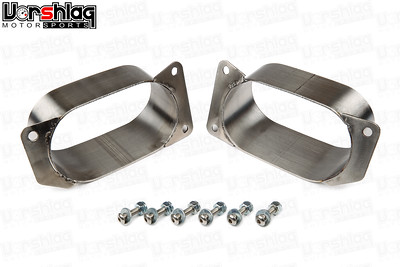

To get air to the rotor backing plates it needs to come from somewhere. On the 2018-19 GT there isn't a great place to steal air from, so we took some dead flat space in the corners of these lower grill pockets, that were likely added for styling.
We include a cutting template to cut a 4" oval hole and 3 mounting holes, then the inlet ducts bolt in and mount on the back side of this plastic grill. Some 4" hose connects the inlet to the backing plates, and now you have brake cooling. We are already working on some other S550 Mustang model variants and will show that next time.

ALTERNATIVE TO BRAKE HOSES
When the S550 first arrived in 2014 we tore one apart and looked at things to improve. We got to explore Aaron's 2015 PP1 car, then this red PP1 I ordered but decided not to buy (the dealership was happy to sell it for more).
We noticed the "scoop and flap" brake cooling that came on the PP GT cars, and while we felt the flaps were a bit on the small side, we had plans for a more traditional "forced" air inlet-hose-backing plate cooling.
Of course the hoses can become a challenge with wide wheels and tires, and of course adding the inlet scoops can force you to cut on the front of your car. We also had some advice from a Ford engineer that a bigger flap than the PP cars came with would help. And strangely, the Shelby GT350 is missing the flaps altogether - but has the undertray duct.
So we took the PP1 brake deflector scoop that mounts to the front control arm and made it significantly bigger. The prototype above is ready for testing, which we will do soon on our car - comparing it to no cooling (like the base GT) and then to our forced brake cooling package on the car now. We will share the results, and if it is as helpful as we think it will be, these will go for sale on our website shortly thereafter.

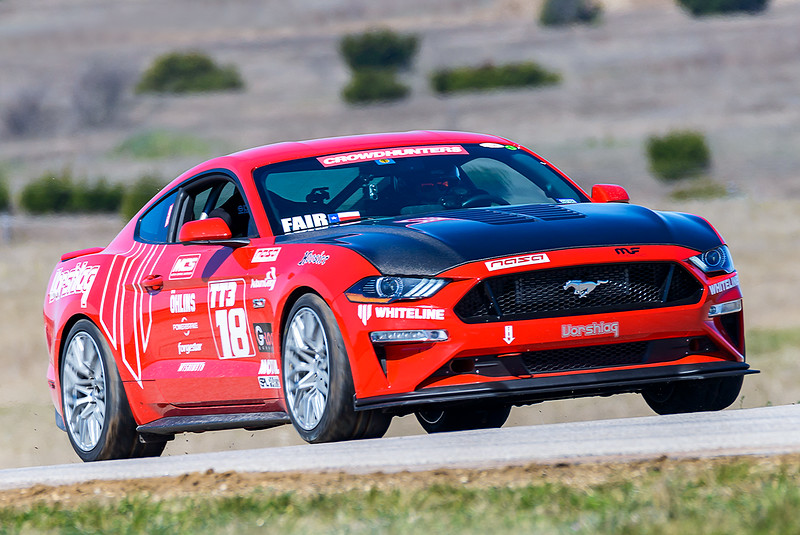

Project Update for April 15th, 2019: The last update was cut short due to the volume of info we had to share and the limits of most peoples' attention span. ;) This time we will cover the event right after the first round of 2019 mods (power!), which was the 2019 season opener NASA TT event (where we ran the car in TT2) in January. While running at MSR Houston that weekend we got more RE-71R vs Hoosier R7 lap times to compare, then another round of work followed that event that we will cover.
This post MSR-H work included a LOT of things: a gearing/speed analysis, the Auburn Pro diff + 4.09 gears + aluminum diff housing build up and install, which included both a last minute rear axle install and an S550 pinion flange / driveshaft "running change" issue we found. We will also show the new Anderson Composites GT5 carbon fiber hood install (with weights), PP2 splitter install (and the many items we had to order!), show some wheel/tire weights, a new rear muffler upgrade, Mishimoto radiator install (and weights), and stop there.
We have since changed classes again (above) and attended another NASA TT weekend (March, TT3) plus an Autocross (CAM-C), but we will cover those events next time. The power level and weight are both getting to the point where it is nearly impossible to stay legal for TT3, so look for a move back to TT2 for the rest of the season for this car. The TT2 and TT3 classes are serious enough in Texas region that it looks like we might not be competitive (we'd do better in TTU or TT1) in a street car we refuse to cut on - so be it. The NASA classing is secondary to the parts development and raw lap times we are wringing out of the car.

That event highlighted not only that you shouldn't up-class when you are 500 pounds too heavy, but also how badly the gearing and worn out OEM Traction-Lok differential were. Since then we have finally made the upgrade to the built aluminum "Super 8.8" housing, new gears, and a prototype Auburn Pro differential. Wish we had the time to get it finished before this January event, and that plus being wildly overweight/under powered for TT2 definitely put us on the back foot for the weekend. Of course TT2 became the largest and most competitive class at this event - I sure can pick 'em!
Event Photo and Video Gallery: https://vorshlag.smugmug.com/Racing-Events/NASA-MSR-H-012619/
Amy and I left early Friday morning to make the 6 hour tow down to the southern tip of the greater Houston area from our shop at the extreme northern end of Dallas metroplex. We got there at 1 pm and in hindsight, we should have done the relatively inexpensive test day at the track, to try out all of the new changes to the car over the Winter and work on dialing in the new setup (going from Ohlins R&T back to MCS RR2 remote dampers and stiffer springs).
