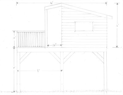

    Thank you for the input. I had thought maybe a 6x6 for the corner posts would be better and still go 4x4 for the other posts. I could just set the rim band on top of those and use brackets there. I would be running my joists the 8' direction for the sake of simplicity.
    Here's my sketch of what I am planning. They are pretty light, sorry. post cut.jpg side.jpg

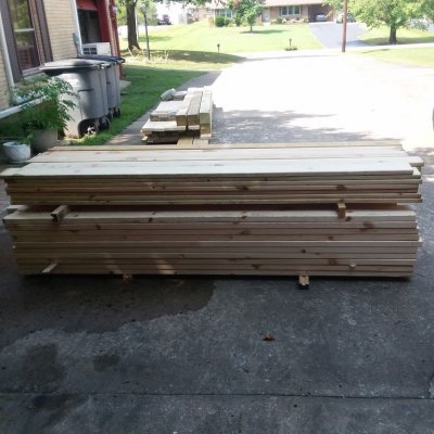

    Lowe's brought the lumber Saturday.
    After an afternoon's work.

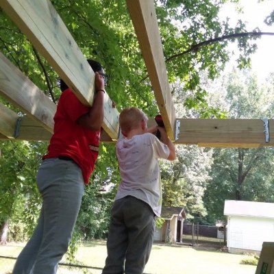

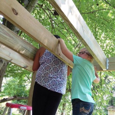

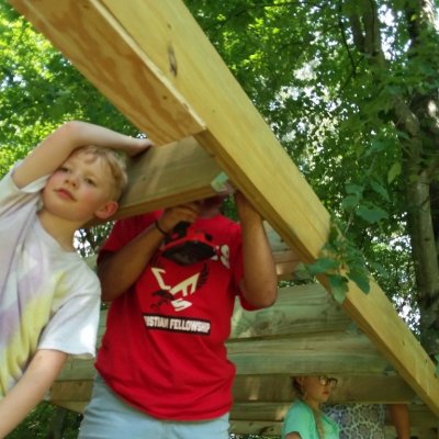

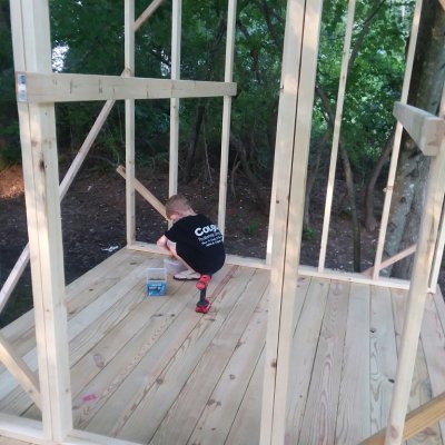

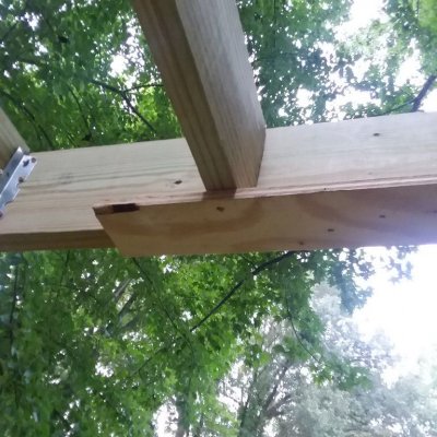

    Day 2. Safety is very important.
    Since I was doing a good bit by myself, I attached a scrap of plywood to the bottom of the rim and set the joist on it while I hung the joist hangers. I am sure that I didn't come up with this before anyone else.

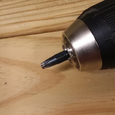

    The kids are hard on bits. I think they think the grinding sound means they are working harder.
    Don't tell the wife this whole thing is a ruse to get to buy some new tools.

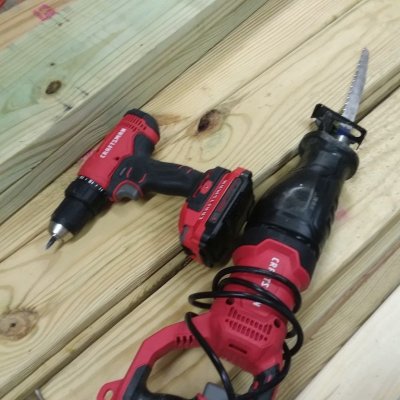

    People talk crap about Craftsman power tools, but this thing is STOUT. If I did this stuff for a living I probably would go with Dewalt or Milwaukee, but for home use I love these things. Everything done on this project so far has been done with this. Other than digging post holes. The lag bolts were done with it too. I went behind with a ratchet to get them sunk into the wood, but it dang near twisted my arm off driving them in. The recip saw works great too. Gets a tad hotter than I like, but ripped through the 6x6 posts pretty easily. And with a 10 year old blade on it because I can't find my new one.

    Great job/start on the fort, but can't agree w/Craftsman tools...their quality went to crap in the 90's. Most of my power now comes from Hitachi and/or Milwaukee.

    If I did this for a living I would go with Dewalt or Milwaukee, but for home use these are gonna be fine.

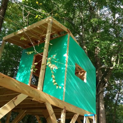

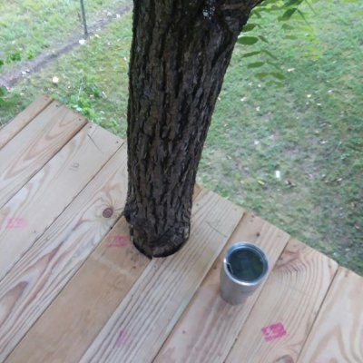

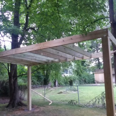

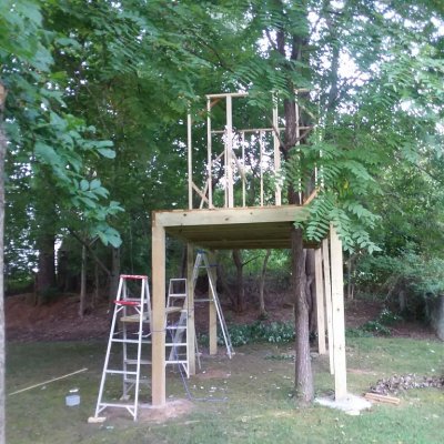

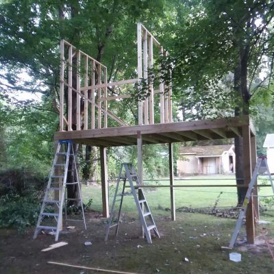

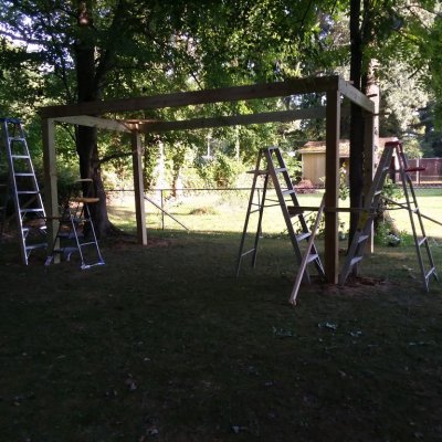

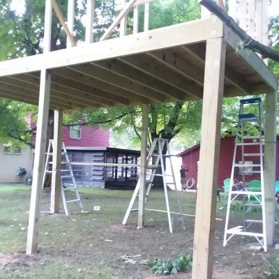

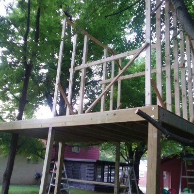

    An 80 degree Saturday got me to this point.

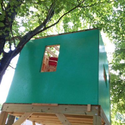

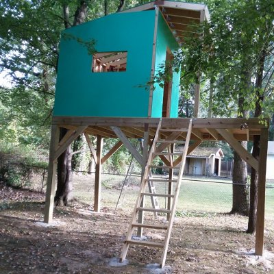

    I had to take down the back wall and shorten it. I was hitting the tree and either had to move it in about a foot or make it shorter.
    It's only a tree fort if a tree is involved, right?

  11. Gabe
    Gabe Whippled Coyote
    7,275
    339
    Is that tree done growing?
    Cuz it would suck if in a year or 2 the tree's larger girth might spread apart those boards.
    Looks good though!

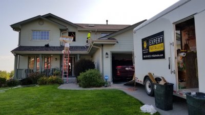

    After dealing w/horseshit wood windows f/ years (leaking, painting, fixing, etc.) finally bit the bullet & hired Pella to install all new vinyl windows. This is when the crew started...more pics later of finished product(s). Super happy w/Pella (crew & quality). :D

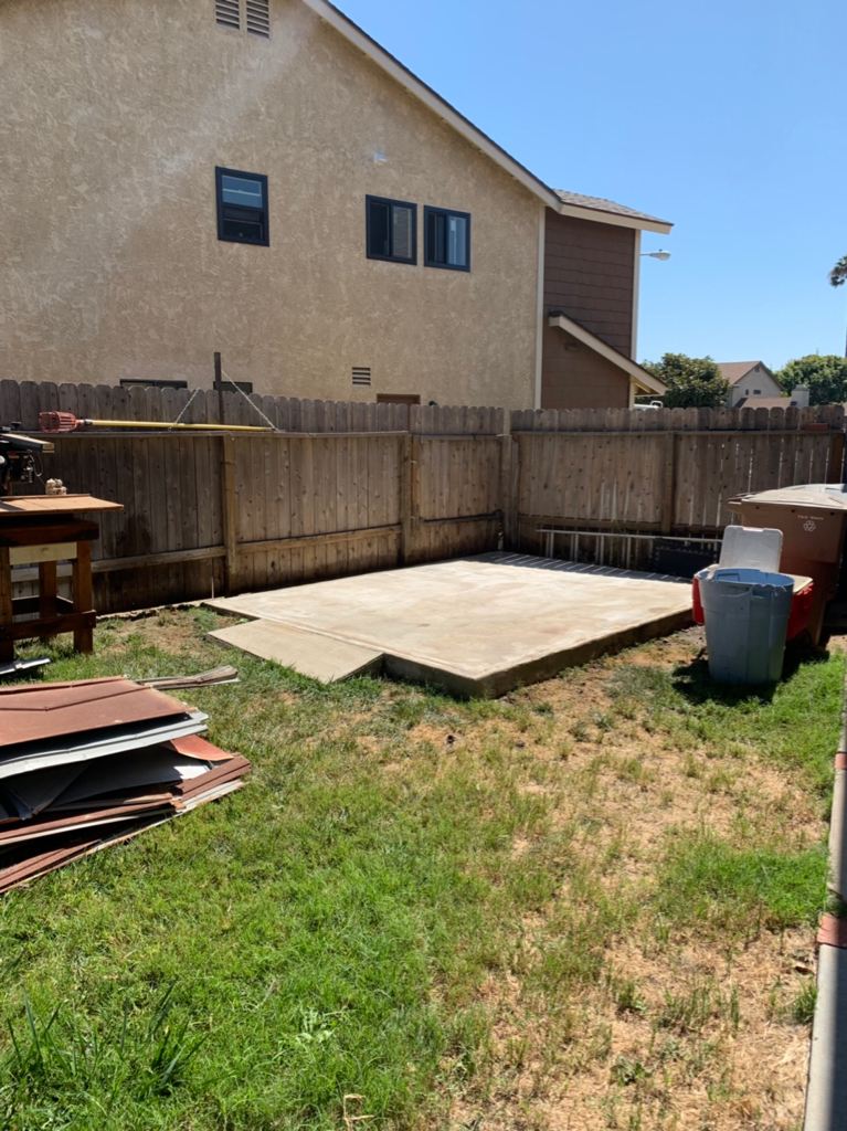

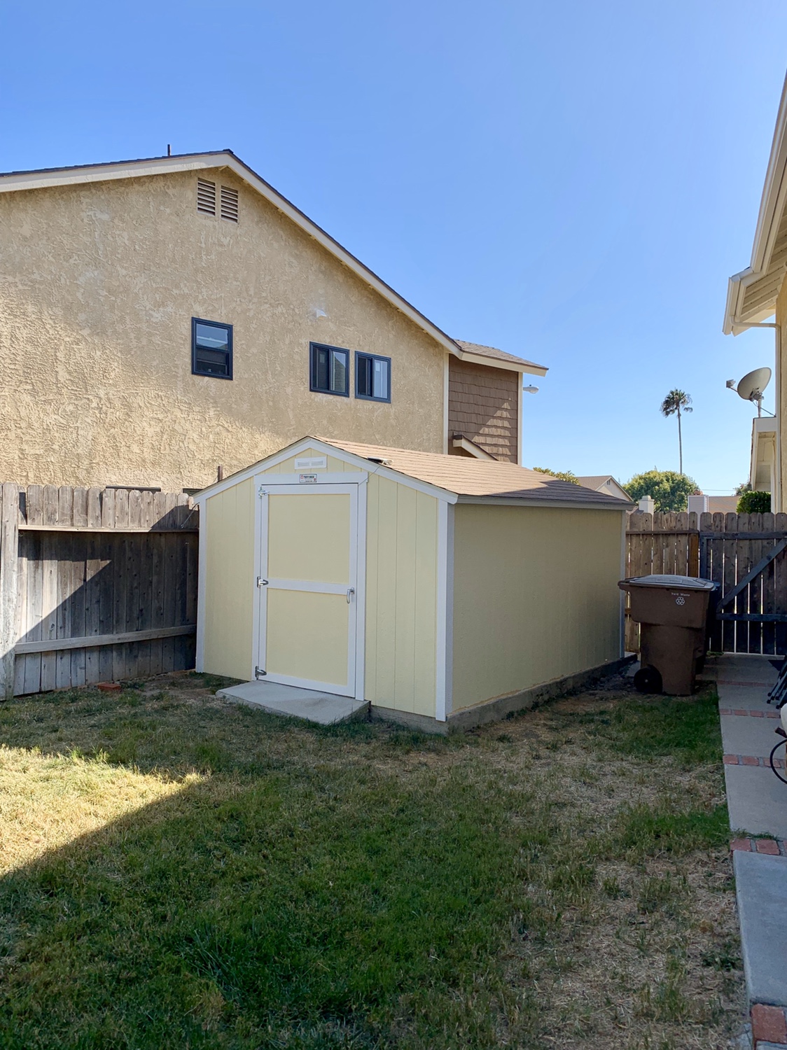

    Demoed my old rusty steel shed. Going to replace it with a wooden one painted to match our house.
    [​IMG]
    Sent from my iPhone using Tapatalk Pro

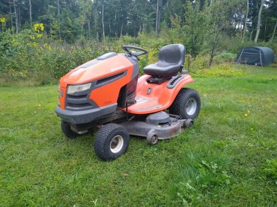

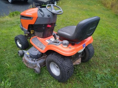

    Picked up a new-to-me 48" riding mower, this one being a Husqvarna with a 23-hp V-twin Briggs and Stratton Intek engine.
    From what I hear, not a great line of engines, but I thought it was a great buy for only $250. It runs great, the battery has an 8/18 date code on it, and it has a new deck belt too.
    Doing an oil/filter change tomorrow, cleaning it a bit, and making some adjustments, then hoping to use it right away to mow the lawn that's close to needing to be hayed by now.

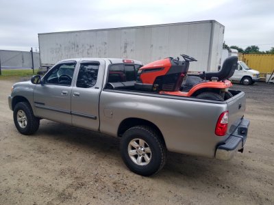

    It's wider than my little trailer can handle, so we had to just go with my truck ('06 Tundra) and improvise getting it in there, since I have no ramps and the guy's ramps sucked.

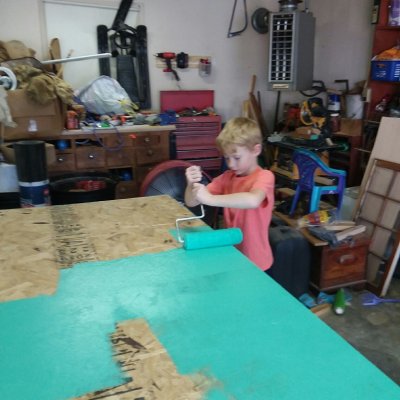

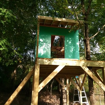

    DISCLAIMER: I had zero input on paint color. My 7 and 8 year olds picked it out. Would be awesome if anyone was a Dolphins fan..... but hey.
    Getting close. I have to put on the last section on the roof then shingle it. Then it will be the railing, windows, a few small side pieces, whatever else I haven't done, etc.
    outside1.jpg outside2.jpg outside3.jpg outside4.jpg paint crew2.jpg paint crew.jpg

    [​IMG]
    And here’s the new one!

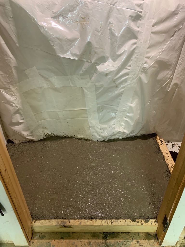

    Worked on our CrawlSpace
    Insulating, encapsulating
    NC red clay sucks
    Poured a small pad to the entrance
    [​IMG]
    [​IMG]
    [​IMG]
    [​IMG]
    [​IMG]
