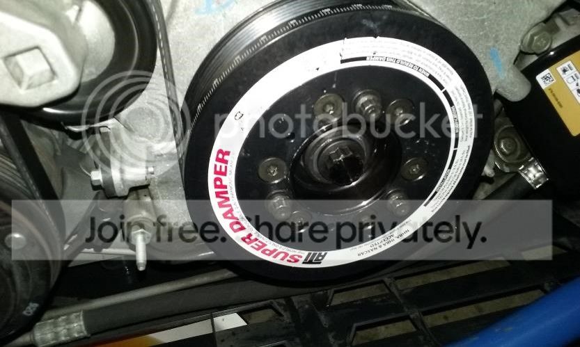

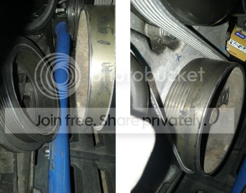

Discovered this little surprise on the stock crank damper
Car suddenly quit making boost and developed a slight belt squeal
Opened the hood to find the rubber bond had failed and the inertia ring / crank pulley had set itself free – and left a burn mark on the sway bar for good measure
Amazingly, the belt walked over the pulley’s rear guide lip and right on to the damper hub

I spun mine on my Bullitt at the race track, threw the belt but didn't come completely off.

It looks like time for a ATI dampener. That's what I put on when I installed the Whipple.

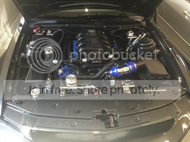

Installed a new one piece painted radiator cover (yeah, the lighting sucks). I need pick up a couple black bolts as I not want to deal with the little caps that came with the kit.
