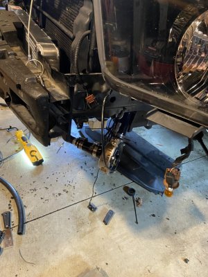

Davis Craig DC-8140, 30 gpm @ 10 amps. $169 from Summit. It is actually an engine water pump. I haven't actually measured flow yet, but it is noticeably more than the Pierburg pump from DOB. Once I have an actual GPM rate, I`ll post it.

just curious, I did the same thing a month ago using the VMP heat exchangeer with the 1" inlets and outlets. I dont know if your pump flows the same direction as mine, I pumped into the bottom of the heat exchanger, dont exactlyremember why, maybe something to do with easy priming?

I don't know if it will make any difference, but I put mine at the lowest point in the system so it`s always pushing water instead of pulling water.

Ditto, i put mine in the same location, I was just curious if yours was "pushing" into the lower heat exchanger fitting IE what direction is your fluid flowing? IDK if it makes a difference
