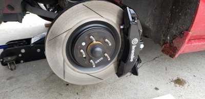

You must have a low jack...my car is only lowered 1.5" and I have to drive the car up on boards to get the jack under any lifting point on the car.

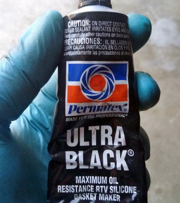

I noticed that mine was leaking after only a few hundred miles after install. Black RTV is an adequate substitute for the Teflon tape?
Yeah. My tech-friend that installed my blower and has his own shop said he typically uses black RTV these days instead of Teflon tape. He's heard from a few people that over time oil can eat through Teflon tape (the petroleum distillates or whatever, automotive oil)
I sent a message to AEM asking if the sensor rotating inside the body was normal, they replied today saying that it's not, so I guess I'm looking for a new sensor. AEM # 30-2131-100, just wish it wasn't $65, holy crap.
This is the RTV I used:

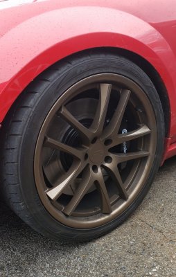

2" with H&R Super Sports. What size wheels are you running?
What size tires too? I have to pull my front wheels on to a 2x4 to get my jack under the front. Granted, I don't have a low profile jack, which I'm gonna have to get.b
