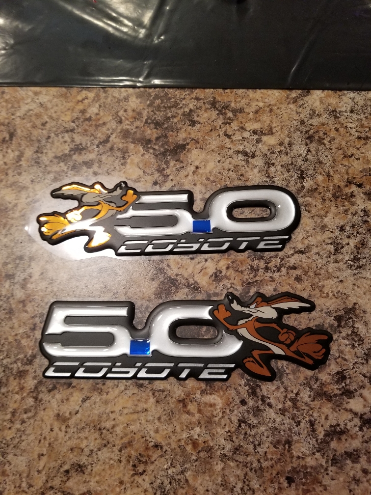

Dude relax, it’s the combination of the Coyote emblem, whi always used to Acme products to try to catch the road runner. It’s an old cartoon in case you’ve never seen it
Omg I didn't even realize what the joke was...
Yea I'm a total dumbass
Yea now I get it....
Geez.... Lol [emoji2936][emoji2935][emoji2357]

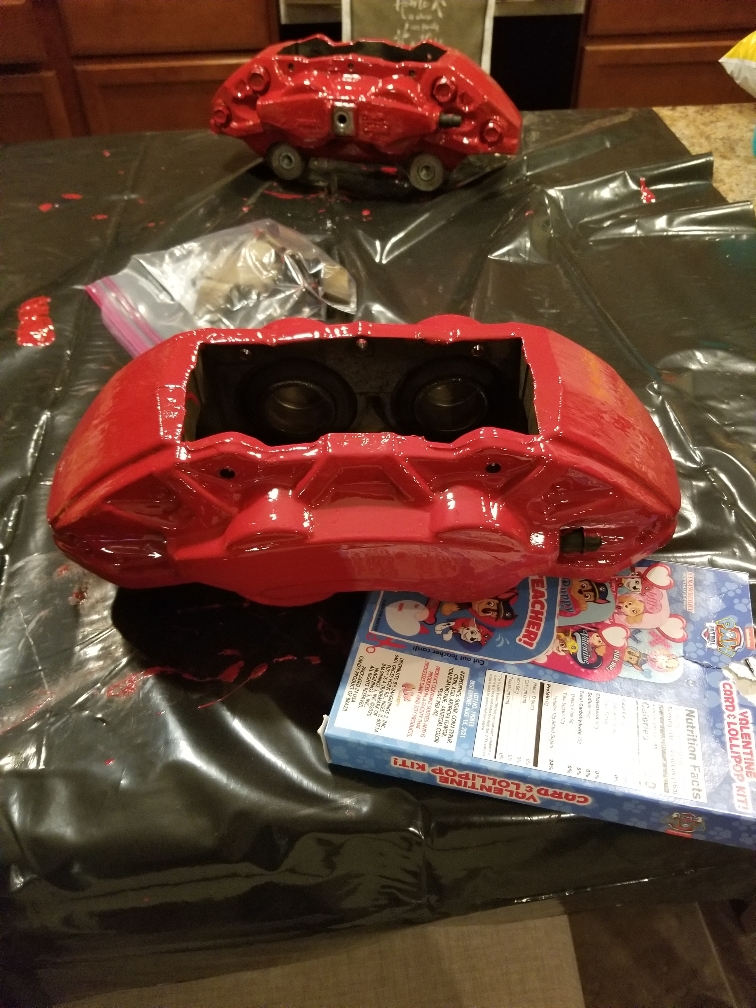

Getting ready for a brake and badge swap
Do not trust any tunnels!

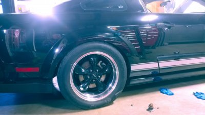

Finally got the FRPP suspension out and replaced with the Vorshlag divorced coilovers. I had some QA1 adjustable shocks that a customer never picked up, so in they went.
Also cut the jounce bumper down.
With the spring platform not quite at the bottom, it dropped the rear about half inch more than the FRPP springs. I'll be adjusting once I get the new wheel/tire setup on.

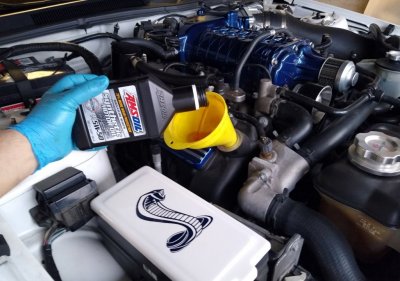

Today, not on my car but the wife's Shelby, changed the oil and filter, and drained the oil catch can.
Fresh Amsoil 5W50, fresh Ford/Motorcraft FL820S filter.

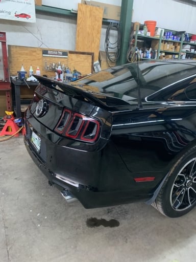

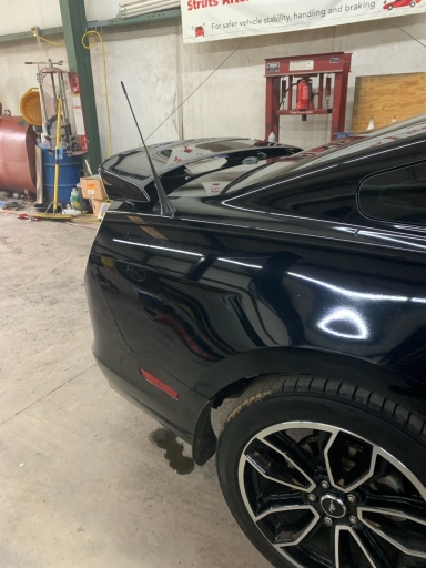

I just installed the new 20's. I'm not in love. I'm going to lower the front about 3/8 and raise the rear about 3/4. Might help, Idk.
