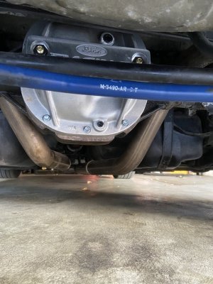

New outer tie rods. One had a ruptured grease boot so I replaced both.
Installed Ford performance lower control arms. These replacements and and a wheel alignment made a big improvement in steering response.
Also replaced leaky diff cover with Ford performance aluminum diff cover with girdle brace. 0707D1C7-633F-48D9-AF1D-58F41D919F11.jpeg
