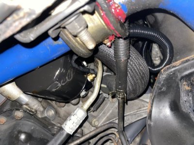

Don't think I ever posted this. You all running a trans scoop?
