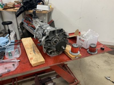

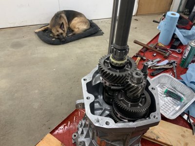

Had a good day. Set sixth driven gear and shaft end play. Installed bronze fork pads and close up the main case. Shift rod engages first four gears and neutral like it should.B5513771-D96D-479C-BD25-4E99316251DA.jpeg 4B521471-E472-4210-AF94-5F913200C22A.jpeg

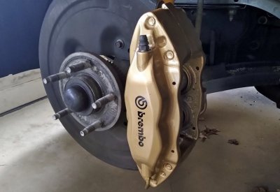

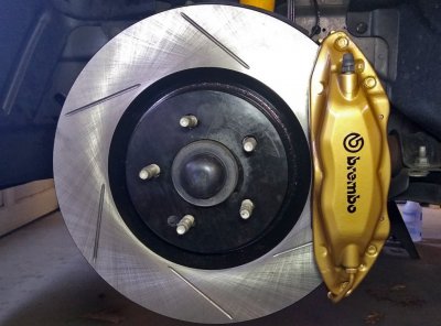

Decided that I hate VHT caliper paint and that I'll never use it again
I used the VHT header paint for my...headers. I've never really had great experiences with painting headers. So, I modified an old electric oven to bake them. I built a sheet metal box the size of the oven door when it's fully open. So the door became the floor of the oven extension. I made the whole thing double walled and stuffed it with insulation. Made a lift off lid. Then I baked the headers for the directed time. That was 4 years ago. The paint has held up surprisingly well. I'm just now starting to see some rust specs coming thru, but that was only after driving it once on a salted road last winter in CT. So, if you have access to an oven, it will definitely help. Not sure what it would do to the seals on the calipers, but I think they would get hotter on the car than most ovens would get.

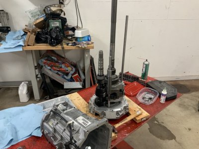

Today saw fifth, sixth and reverse added to the tail end. Thermal fit a couple gears and they slipped right on. No more parts to go inside.EB45878B-BE6D-441D-8A10-7D5A956094A6.jpeg

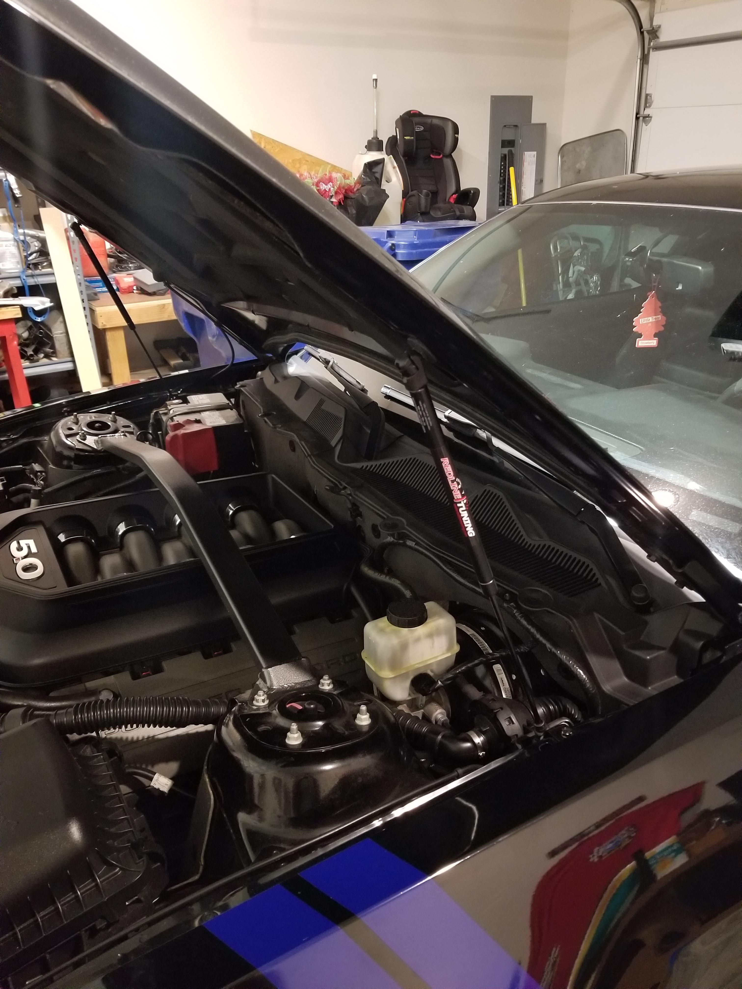

Installed redline tuning hood struts. Literally a 5 min job with my 1/4 Milwaukee.
Easy as pie...

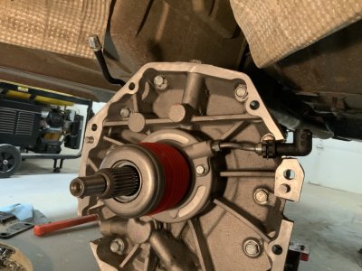

Hey Brick
You mentioned having to rework the tube on the slave cylinder. This is what I ended up with.
