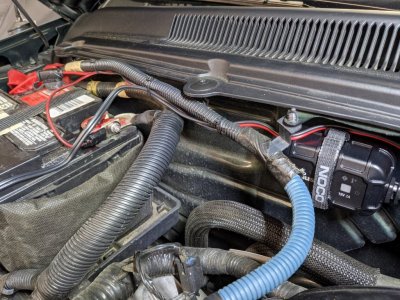

In preparation for our looming transition from fall to winter, where the Bullitt goes into hibernation, installed the Noco battery maintainer I bought earlier this year. Saw it on Amazon Prime Day and thought it was pretty cool...mounts under hood.
