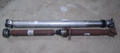

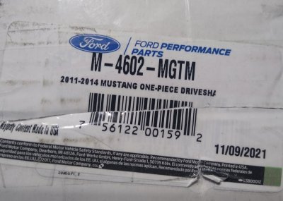

Ordered a 1-piece Ford Racing aluminum driveshaft.
Finally going back to a 1-piece again after my shitty experience with the DSS unit a few years ago.

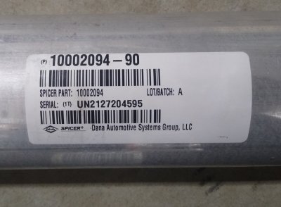

So, apparently, Ford Racing 1-piece driveshafts are made by Dana Spicer

Gabe,
How much did the one piece cost?

Installed coilovers front & back and Steeda Watts Link
Gabe,
Amazon, $660 with free shipping, plus sales tax.
Yesterday I ordered a new Prothane rear diff bushing.
Gonna install it at the same time as the driveshaft, hopefully this weekend.
