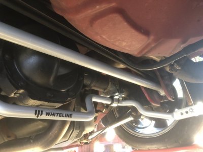

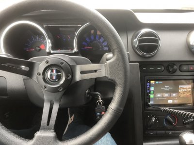

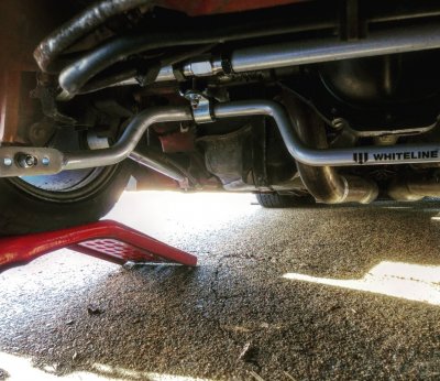

Got adjustable sway bars and rear lower control arms installed. Nice and tight in the corners. Also put in a volante steering wheel wich I’m really liking. Plus my cruise control doesn’t work due to the coyote swap so the buttons on the wheel where pointless.

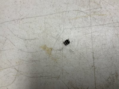

What is that?
Valve keeper. Just like Kazman59 said. Changing valve springs with engine in car is a nightmare. Even with the correct tools! I can’t get my old, less agile fingers anywhere near the exhaust valve keepers and down it went. Thankfully it went to the bottom of the pan. Now the heads are on the bench and all the springs are changed.
