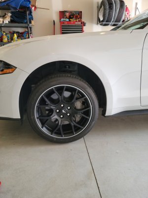

Washed it, clay barred it, then waxed it. I thought I had bunch of chips in the paint but turned out to be track rubber spots.
Then I put some Rim Blades on it. While I like black wheels, the all black has never appealed to me. The Rim Blades give just a little lip to separate the wheel and tire.20220501_124259_resized.jpg
