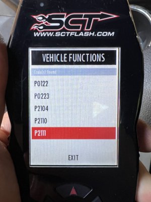

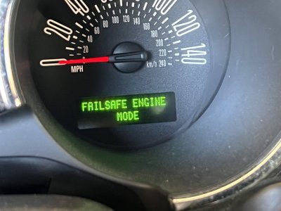

My “what the hell” moment for the day:
1D00BA2F-E218-4369-9056-27516EFB68D3.jpeg 4303D90F-E68E-4AD1-B101-CCACF4BD9940.jpeg
Pulled the blower/intake for a repair and put it back together. Throttle body forgot what it was supposed to do. Took it apart, put it back together and it worked.
What the hell…

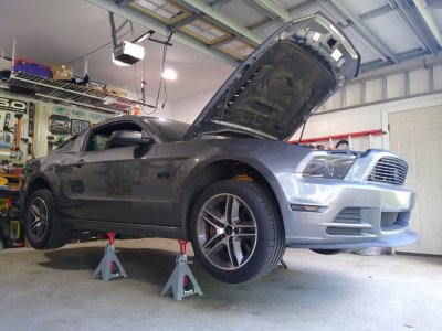

Replaced the rear diff upper bushing with a Prothane unit, changed the oil with some fresh Amsoil 5W50, installed a new Motorcraft filter, and replaced the 2-piece driveshaft with a 1-piece Ford Racing aluminum unit (made by Dana Spicer).
That garage…that car… sure does remind me of an old long lost friend of this forum, that lost his way.
I’d be speaking of the sterility of the place of course. You don’t happen to take your shoes off and where socks on your hands by any chance when you in there, do ya?
