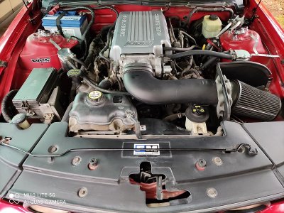

Tensioner, and old belt are less than two years old. Just changed it because radiator sprung a leak and coolant contaminated it. I’ll be switching again to a 2” shorter belt when I add the smaller s/c pulley, and clean all the pulleys/idlers again. We’ll see
I had a bad idler pulley bearing with a chirping sound, then replaced all bearings and found a 2nd bad one at the tensioner. Just replaced the bearings, below 20$ for all.
FYI: I used a Conti Elite cogged belt for my small Mercedes supercharger and it was eaten up in record time. I guess the contact surface to the pulley is smaller.

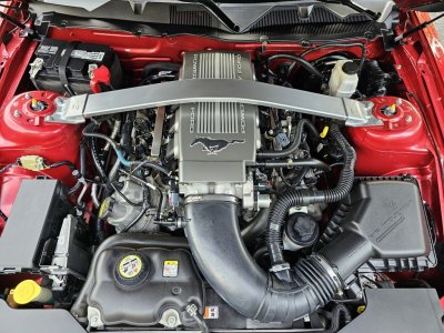

Which strut bar is that?
Gotta pick out springs. Debating wasting money on the strut bat or not right now.
Thinking I will be going with the FRPP intake manifold down the way. Looks like the bar you have will clear.

Yes Boss 302 style. Great to know that does fit over the intake cover. Thx for posting the info.

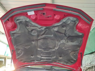

I found a simple and effective cure for the notorious hood flutter on 05-09 Mustangs by sticking some 1" thick foam on the inside of the hood with double sided tape behind the leading edge. Now when I close the hood, the gap that was big enough to stick my fingers into (except for a small section for getting to the hood latch) between the hood and the front slam panel is completely sealed.
Another factory flaw gone!

Some remarks, I tried this on the right side of the hood, I have a FR CAI so cannot block the air on the left, with no big effect. I guess you modified the undertray, I (MJ 07) even do not have the middle part to the K-support and you installed the hood struts. I think the combination of all three does it?
Ford saved money, my Mercedes has 3 latches for the hood.

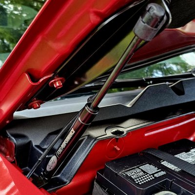

Yes, Ford did cut some corners on smaller details that would have made the car better. I added Redline hood struts, CPC radiator cover extensions, a Silverhorse Racing trunk release switch, a 2010 Mustang engine splash shield, and DIY front undertray extensions. Note that I cut a small hole in the passenger side radiator cover extension in order to retain the stock hood prop in case the hoot struts go bad.

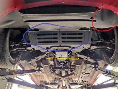

I try to do a home re build of the missing parts for the underbody. For the A-arm brace a used a standard steel tube, squeezed the ends with a shop press, drilled 4 holes in it and installed it with nuts/bolts. Big difference in driving.
The side parts (red circle) I used 3 mm ABS to fill it and the blue middle part I'm still working on with 4 mm ABS, but it is more complicated than I thought to mount it to the K-Member.
