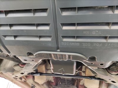

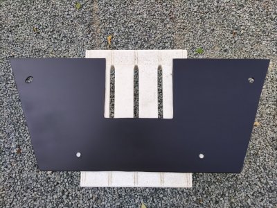

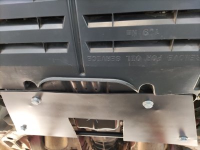

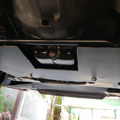

Installed a Ford Performance A-arm brace (standard fitment on 05-09 convertibles & 07-09 GT500 but not on 05-09 V6 or GT coupe), and I also finally finished off fabricating and installing my custom composite K-member undertray for a further reduction in aerodynamic drag.IMG_20230909_141845.jpg IMG_20230909_160124.jpg IMG_20230909_161555.jpg IMG_20230909_162455.jpg
Note the cutout for the sump to allow oil changes without removing the undertray. :D

did you attach a heat shield on top? For the heat of the catalytic converters?
There's plenty of space between my undertray and the cats so a heat shield isn't necessary.
My 08 GT coupe, bought new by me, had that brace.
Interesting. Is yours a Premium model? I don't know why Ford didn't just fit the brace to all 05-09 models. It's not as if it's an expensive part for Ford to penny pinch on.

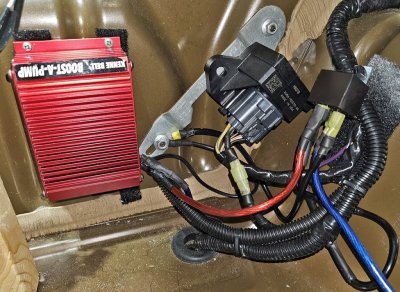

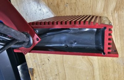

Got back to checking out my BAP issues.
Removed it, took off the end plates to see what it looks like inside, and was disappointed to find just hard black goo and nothing else.
Apparently Kenne Bell covered up all the guts in that stuff, and all you see is a few wires coming out of it:
I found 2 iffy connections, one for the 17V wire going to the wire at the fuel pump driver module, and one at the main power wire going into the BAP.
Took them apart, re-did the connections with fresh wire and solder, heat-shrink tubing and electrical tape where needed, and also cut back, stripped and re-connected the wires for the un-used Hobbs switch and adjusting knob, since this setup is wired so the BAP is always putting out 17V.
Put it back together and tested it, and got a solid 17.09V out of it.
So there's a chance that all my fuel issues were caused by bad connections.
I'm not 100% sure of it, but at least one of the connections was pretty crappy, and it's now 100% solid.
While I was at it, I re-located the grounds for the relay and the BAP, and added a quick connect/disconnect setup for the 17V wire going to the FPDM from the BAP, so if I have to remove it in the future, I can easily unplug things and pull it.
In the above pic, the blue wire on the right/bottom is the upgraded power wire coming direct from the battery (with a 30A inline fuse near the battery), the thick red wire provides power to the BAP, and the black wire with the yellow connector close to the FPDM is the one providing 17.1V to the FPDM

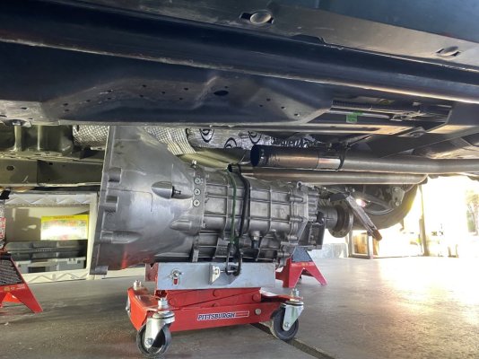

Finished up going into rear axle & replacing both the diff carrier & pinion inner\outer bearings & races w\ Ford Performance M-4210-MB kit (Hi TQ inner pinion bearing designed to run w\o the spacer) then set up (started this work Friday afternoon).
I should've done this last year when I replaced the whining Richmond EXCEL 3.90 gears (Ford 9" pattern 3.89 ratio 9 pinion\35 ring non-hunting) w\ a set of Motive Gear F888390 3.90 gears (3.91 ratio 11 pinion\43 ring full hunting). Used Motive Gear Ford 8.8" kit when the Richmond 3.90 gears were initially installed by a local shop & had low miles, so I decided to reuse them..........
The evidence I found showed this to not have been a smart idea........even though I actually checked them over prior reuse but obviously not close enough.
Too worn out & sore (also dark......finished up just past midnight) to put car on the ground to test drive. Tested all while car was still on jack stands (had rear axle relube all bearings & checked rear axle for any undue noise while under no load operation........all good w\ no leaks, runs or errors) & let it run in gear while I was picking\cleaning up for the night.
Test drive coming in AM............
PS--Put car on the ground & test drove her this morning.........am happy to report that all this is now resolved.

On the KB boost a pump that gooey stuff is actually elostometer used to pot the electric connections. It’s there to protect the internals from vibration and moisture.
If it was just wires and a circuit board I would have been very disappointed in KB!

Installed a Ford Performance A-arm brace (standard fitment on 05-09 convertibles & 07-09 GT500 but not on 05-09 V6 or GT coupe), and I also finally finished off fabricating and installing my custom composite K-member undertray for a further reduction in aerodynamic drag.View attachment 89370 View attachment 89371 View attachment 89372 View attachment 89373
Is that plastic piece that says "remove for oil changes" in front of your new part a factory part? My 2005 does not have that.
Dino Dino Bambino
I have a red car
Aug 11, 2014
4,545
2,672
Cyprus
That engine splash shield (Ford part no. AR3Z-6C038A) was only fitted on 2010 models but it can also be retrofitted to 05-09 models. It's a simple bolt on affair and that, together with my custom K-member undertray, really cleans up the front underside of the car and reduces aerodynamic drag. The main benefit is improved highway fuel economy.
I try to do a DIY rebuild of that shield, OEM not easy to get here. If you have the opportunity, can you make pictures of the mounting points? E.g. are there nuts in the holes above the bolts of the steering rack? How is it mounted at the K-member? Thanks!
