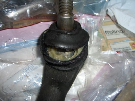

Changed both tie rod ends because the boot cracked. Cheap rubber combined with a bell shaped designed, not made to last 10 years. The new ones, made in Korea, have at least pre-formed rubber design.
Took me one hour per side.
I read in a Mercedes workshop manual that you should spray all nuts and open threads at suspension parts with wax spray, which I'm doing now.

Get Moog replacements. Lifetime guarantee.

I second the motion. Moog also has greasable zerk fittings.

After my tie rod end change I corrected the toe in with a tape measure.
With the old tie rods still in place I put the steering wheel straight with a water level and measured the wheel distance (marked the place at the profile with paintmarker).
With the new tie rods in, I corrected the distance to the value I measured, precision of 1 mm. It will not be 100% but acceptable, I hope....
