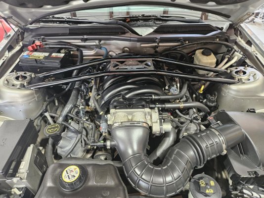

Replaced the rear swaybar bushings, rear shocks, front struts/springs, swaybar links and strut tower brace on my new (to me) 08 GT. 112,000 miles and they were worn out. Drives like new, now. Wanted stock-ish and budget friendly, so KYB was the ticket. Very happy with the way it turned out.1000009054.jpg

Nice. With that age and mileage, would be a good idea to check the upper diff bushing. It's probably all cracked. Not a terribly hard job to do. I've replaced them in my wife's '08 Shelby and in my '13 GT

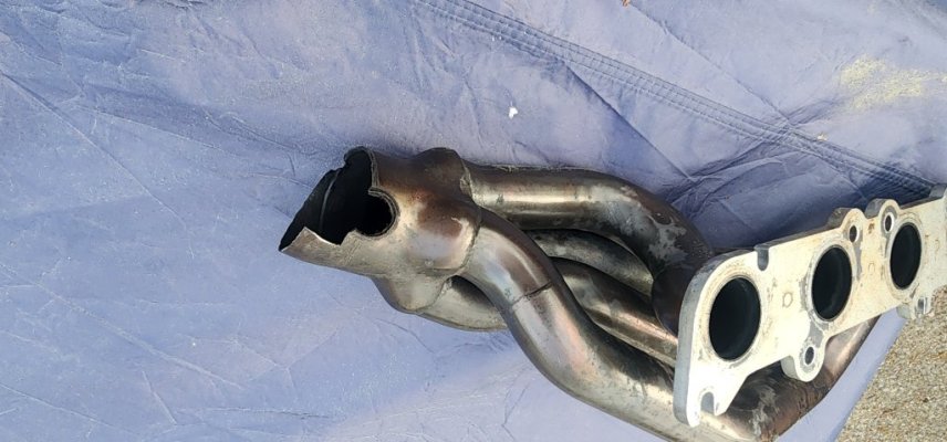

Fairly long list, and its been a months long project. Replaced phaser deletes with new phasers and phase limiters, replaced broken chineseum headers with LTH long tubes, added Division X 2 pump return style fuel system, changed to 1100cc injectors, changed to Whipple 132 throttle body, replaced defective phaser with another new one, added Forgestar CF5 wheels, and finally switched to GT500 size rear rotors. In between all of that, ive been datalogging, finding out that i have a bad phaser, finding out that i was running on one pump because i didnt read the directions propperly, and trying to figure out where to get good E85 in my area.
Ordered. Was your UCA bushing OK or did you wind up changing it, as well?

I replaced the UCAs on both cars a long time ago, lol. The Shelby has a Steeda unit, mine has an adjustable BMR. Both have poly bushings, still going good

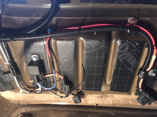

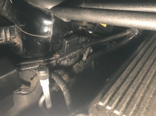

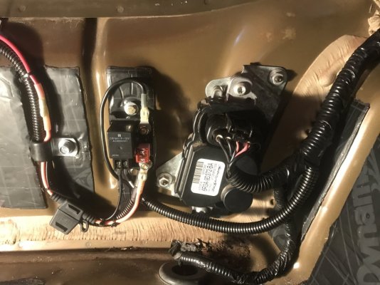

Finally got around to upgrading my 8 awg Fuel Pump Wire Mod 40A relay to use a Leash Electronics Hi Output Relay Station (shout out to lwarroir for posting the link) fused to 30A at the relay station, thus allowed me to up the fuse at the BEC to 50A (just because.......same 50A fuse that JeremyH sends w\ his 8 awg Fuel Pump Wire Mod kit) & upgraded the 12v+ power feed wire from Leash relay station output to FPDM 12v+ power in terminal from the 10" section of leftover Ford OEM 16 awg wire to 12 awg wire......then wired up a secondary 12v+ power setup using the now spare 40A relay w\ the spliced LFT rear reverse light 12v+ power from SJB as trigger wire to power my Ford reverse backup alarm system & upcoming reverse backup camera system to hook up to my existing Kenwood Excelon DNS 995 head unit (has reverse backup camera capability built in). Put in a 15A ATO fuse off Leash relay station 12v+ power input lug, then a 2A mini fuse to Ford reverse backup alarm controller..........will be putting in another 2A mini fuse in the other Mini Fuse holder for the reverse backup camera when install is completed.
Found that the speaker beeps on the Ford reverse backup alarm system got louder since doing this.......kinda figured that the 12v+ to LFT rear reverse light from SJB was low amperage power thus wouldn't carry much more amperage load w\o causing issues in the SJB circuitry.........this result confirmed my hunch.
Since days are shorter now, I broke this up to do in 2 stages, so the next stage is the actual reverse backup camera installation (been wanting to get this done for quite some time............just kept putting it off).
Gonna pull out my Kenwood install guide & see what needs to be done under the dash........................

PS: Like the black Dynamat, I only got the silver, looks kind of unprofessional.

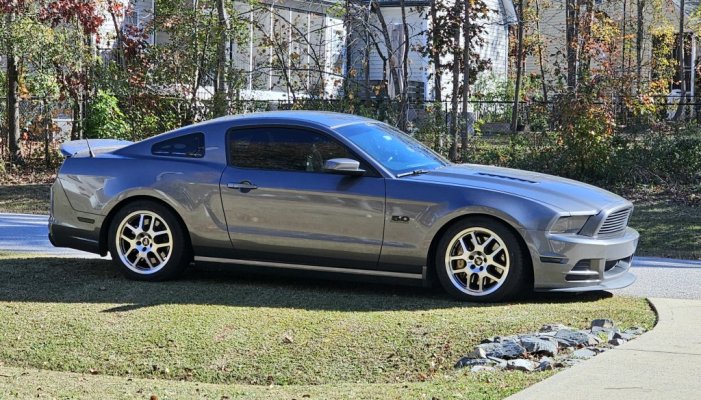

57,947 miles on it, over 12 years since purchase.
Just swapped on the wife's factory wheels which have new 255/45/18 all-season tires on them, hoping that I'll get to at least cross 58,000 on the odometer this year.
Yes, it's dirty.
No, I don't really care.
