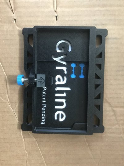

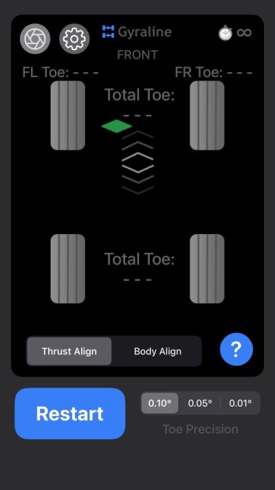

Ordered 1 of these this morning after running across a YouTube video on its use.............................
This is the modern version of jack stands, string line & a tape measure to check\do DIY front & rear alignments...........using this plate & your IPhone's (also have just put out an Android version.......I have an Apple IPhone 7S which is compatible) internal sensors w\ their app...........tested\verified accuracy to .05* which is good enough for how I'm gonna use it.
Gonna use it to get all current front-end caster, camber, toe measurements on my Stang after tire install but prior real alignment check\work to get a real comparison on this tool thus real reference to use for future checks.........as 1 could do using the old school methods.
Finally got this package at my doorstep Wednesday (got caught up in all the Midwest winter during shipping thus USPS delayed approx 1 week)......consists of the Gyraline alignment plate\cradle for the phone (IPhone 6S or later......these phones have the full assortment of internal sensors used w\ assorted health apps that can pick up body motion across an X-Y-Z axis range of movement), centering slide clamp & 3 different length clamping screws (to accommodate assorted width phones from narrow to wide & thumb handle remains inboard of the plate side blocks when tightened).
1st thing off the bat..........the internal sensors in this IPhone are very sensitive to any type of movement ........so when using this thing you have to be very smooth & steady & you really need to have your finger in place prior needing to touch the screen once you establish level or center positions, so you don't twitch\need to move........it's that sensitive........thus I can see where the accuracy will come from.......if you are very deliberate in where\how you place the plate against the wheel rim\edge.........consistency is key to accuracy w\ this product.
You'll also have to remove any protection devices\covers off the phone as the phone won't fit in the plate\cradle at all w\ them installed.........only w\ original designed phone dimensions will it fit so clamp can properly center it to the plate while it's being locked in.........ask me how I know.
Vehicle also has to be on a flat\level surface (same as on an alignment rack) to get good front\rear camber, front caster & Ackermann angles. For rear SRA alignments, all you really need to get are the rear axle toe measurements......these will give you the rear axle thrust angle which is necessary to properly set front toe alignment (or if you have adjustable LCA's.......you can align the rear axle thrust angle to vehicle body centerline if warranted......think "dog walk\track" correction here prior front toe alignment).
I ran this Gyraline thru a quick run to see how it fares..........found out very fast it's not a good idea to have just eaten prior using this thing (had a very hard time being steady\deliberate after a helping of smothered pork chops & rice) as to use this on our S197's on the ground, you got to get pretty low & for an old fat man.....this is hard enough to do as it is, let alone having just finished eating.......so I didn't even try to get any caster measurements after suffering thru getting the toe & camber measurements. Messed up on the camber measurements as I didn't realize to do the offset correction on the plate prior taking them (phone is clamped off-center to 1 side of this plate thus you'll need to do an offset plate correction alignment to plate centerline before taking camber measurements so when you change sides--L to R--you'd be flipping the phone from 1 side of plate centerline to the other........not necessary for toe) so the results came out showing slightly positive camber (L @ .5*, R @ 1.2*) when I know that ain't right (have prior Hunter alignment rack results showing -1.0* L\R camber) so I'll need to redo at a later time. But the toe measurements were very good & showed why the slight pull to right (L tire was 1.0* in, R tire was .5* in w\ centerline toe being .05*.....positive center toe being towards R, neg center toe being towards left) thus car would drift right slightly on centered steering wheel thus had to pull slightly left of center on steering wheel to track car straight forward on city streets........but interestingly, on a 4-lane w\ center medium hwy at speed, she'd track straight w\o any input to steering wheel........could turn the steering wheel loose in either lane & car would track straight.......so maybe something to do w\ the degree of street crowns vs hwy crowns.....?
Shows thru the Gyraline app that a small -.5* adjustment should fix the toe alignment (L side was 23 T's, R side was 23 1\2 T's thus a 1\2 T out on L tire should get this close to .0* centerline toe) .......assuming the camber alignment is good.
Only thing this Gyraline app won't do is save visual copies of the screen results thus you have to write them down before moving on to the next task (erases the results as the app needs to be reset\restarted before doing the next task).
In closing, IMHO, this Gyraline Front\Rear Alignment kit is the real deal when it is used properly & consistently thus, I can see this definitely being\becoming a viable DIY alternative to shop alignments thus can save some real money..........especially if 1 had a full set of something like Race Ramps to drive car onto w\ a set of swivel plates to put under the front tires so they can be easily turned while on these ramps to get the car a little higher off the ground to make using this setup easier while providing access to underside of car to make adjustments.
My intended use is to make comparison measurements\quick checks to see if all stays good after a shop alignment & any repairs.
PS--After doing some reading\studying on Ackermann angles w\ a MacPherson front strut, leading arm steering rack front end (like our S197's......the type of front end design in use does matter), I now can see how bad tie rod ends\wheel hub bearings can cause the innermost edge of tire to get worn off like mine were when front wheels are angled while going thru turns........neg camber has nothing to do w\ this even though it is involved..........worn tie rods\wheel bearings will allow the back\off side tire to flare out of Ackermann tracking degree line due to caster wanting to pull tire back to center, causing the inner tire edge to drag\slip..........evidently it don't take much tie rod\wheel hub bearing wear to throw this out enough to eat up a tire's inner edge over time.

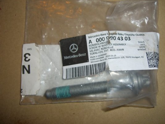

I've got a similar problem, nowhere to get an installer tool (GER), how long does the M12x1.5 10.9 bolt has to be to do your add-a-washer method? Thanks!
GriffX
Sep 28, 2017
1,574
1,096
Rural Germany
Found a longer bolt in my garage from Mercedes M12x1.5x78mm 10.9 (for harmonic balancer install)
Will cut off the tip and scrape the glue out of it, but only 5$

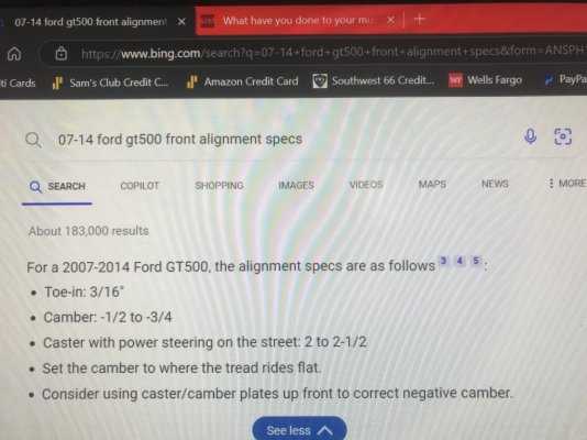

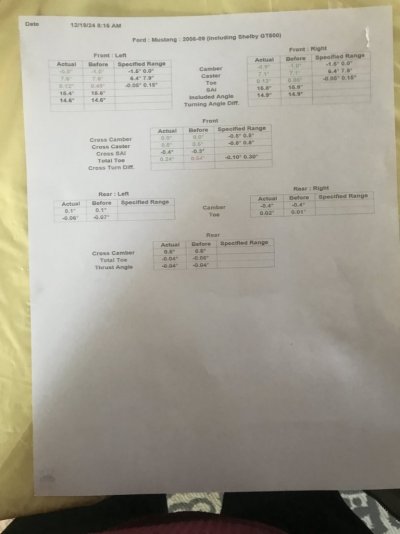

(went by my local Ford dealership to get w\ my fav service writer--he knows all the work history that I had Ford dealership do on my Stang since I bought it, including both prior front end alignments--on availability to do another front end alignment.........showed him the YT video I posted here & informed him of the parts that I found bad & all parts I replaced along w\ the tires.........got her scheduled to go in 1st thing tomorrow morning for alignment so we'll find out if the caster or camber needs to be touched as none of this was disturbed or moved since last alignment on 6-8-22 so expecting only toe to be reset since I replaced all of the tie rods on both sides............)
Got car realigned this morning & provided the results below.................all came out as I had thought it would after inspection\repairs were done. Only needed L\R toe reset.......once toe was corrected, the rest was still good & fell back in line.
This also showed that the Gyraline Alignment kit was in the ballpark concerning toe as well (L front wheel was out of spec from L\R inner\outer tie rod replacements......even though I counted the outer tie rod thread rotations closely on both sides & measured replacement inner tie rods for length compliance\accuracy) & it also proves that the inner tire edge wear like I had is a result of R tire getting pulled out of Ackermann angle tracking line from R worn\loose tie rods & loose R wheel hub bearing while turning L causing this wear.......not due to neg camber even though neg camber is in play on R tire during L turns.
So, now that I have a verified good front alignment, gonna whip out the Gyraline tool soon & capture all the angles to then use as reference for future.

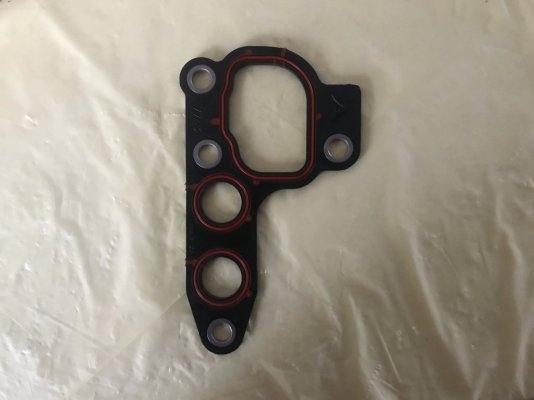

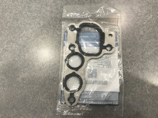

FYI........................

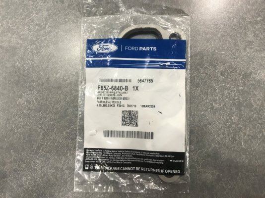

While at the dealership, I looked into getting a replacement oil filter adapter assembly just in case mine is found to be corroded (don't believe it is.......but....) while in process of repairing the small oil leak (coming from under the bolt head that is just above the top oil passage port......the very common oil leak point due to the original gasket design) that's been there since I bought the car..........found that Ford has discontinued these (so EBay is your friend in finding this kind of stuff now) but I also checked to see if the info I heard\read on YouTube of Ford redesigning this gasket was true.........found that this is indeed true (dealership had them in stock). So, I picked 1 up to use to fix this issue on my Stang, hopefully for good.
They're made of metal now instead of plastic w\ metal inserts at the bolt holes & new Ford redesigned gasket now actually seals the oil filter adapter housing mounting bolt holes as well as the coolant\oil ports so once this new redesigned gasket is installed, this issue should now be eliminated going forward.
Sometimes it pays to check w\ the local Ford dealership for updated parts availability for these Modulars.........this is another instance of Ford upgrading components\parts well after Modular production runs are over.

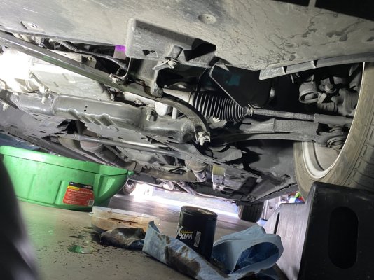

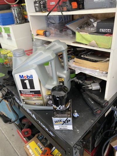

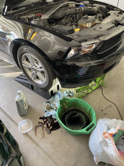

Oil change on our 2011………..somehow managed to make the biggest mess of an oil change I have done in quite some tme.
Back when I worked on the old Alfa Romeos, my boss was doing an oil change on an Alfa Spider. He started yelling for paper towels and another oil drain pan and making a huge commotion.
He had a habit of draining the oil and refilling before draining the old out of the drain pan and had just finished pouring the last of the fresh oil into the engine. Unfortunately, he forgot to put the drain plug in first. So the drain pan was already full of oil and the new just ran over onto the floor.
The Alfa four cylinder holds seven quarts....
