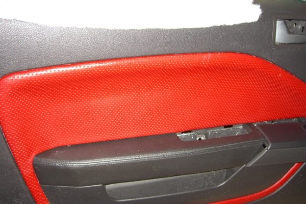

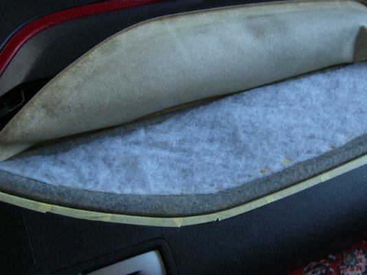

Fixed the sagging door insert, but glued 0.5 cm thick polyester wool below it (white on top as example). Worked good and is as soft to the touch as with the original foam or better. Used a spray glue from an automotive upholstery, I hope I used enough.
First try, I used not enough of it, 2nd try over the complete area and it looked like factory.

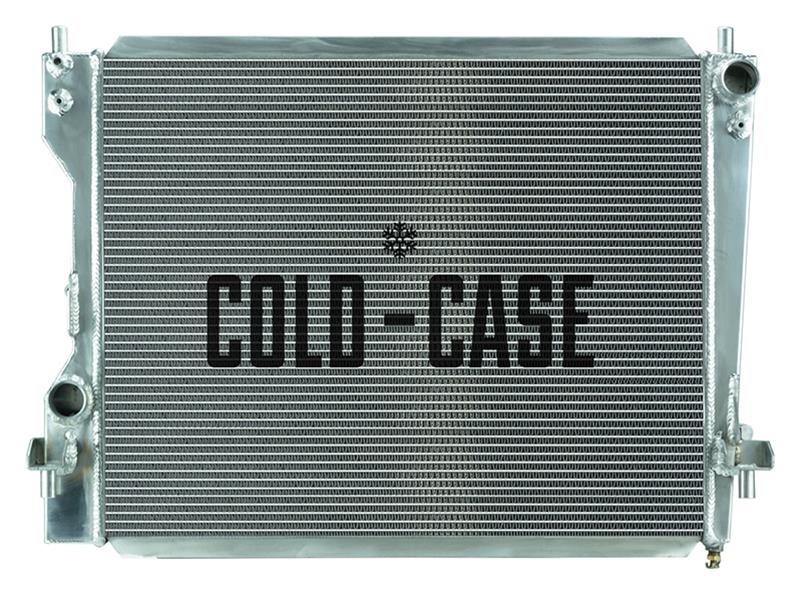

While waiting on this tire saga to resolve itself, got this in today off Black Friday sale last week on American Muscle.............
Cold-Case S197 HP Aluminum radiator (incorporates the latest core design....2 rows of 1" round tubes using 16 fins\in fin density to supposedly increase total cooling surface area some 15% more than a comparative 3-row std core design while also improving coolant retention time & flow rate thru core--less deltaP..........same core design that the now discontinued Ford Performance S197 HP Aluminum radiator used---which sucked as this FP unit was the 1 I was wanting\hoping to get, but I guess I was too late...........) & an Edelbrock HP Hi Flow water pump (always wanted to get 1 but they were always out of stock--mostly due to COVID & Edelbrock moving operations out of California........do I need it, no........do I want it, hell yes & since it was actually in stock, I jumped on it as well) so I have all the parts in hand now to start major surgery (change radiator & WP.....while also doing the full timing refresh\upgrade job--finally have acquired all the pertinent ARP fasteners for the chain tensioners & oil pump among some other items.....while also fixing the known small oil leak on the oil filter adapter housing) as soon as I can talk myself into doing it..........I KNOW I'm gonna be a very stiff, sore & hurting dude afterwards.......

Does that radiator work on automatic trans?
Can't say for sure...........Cold-Case part #LMM574 on AM site, they say this fits all 05-14 GT.......on CJ Pony Parts site, they say same part# fits 05-14 GT & 12-13 Boss 302....both auto & manual trans.............
But on the actual Cold-Case box label, it says 05-14 GT w\ MT (manual trans) ......... From past experiences, CJ Pony Parts has repeatedly shown\proven to be more accurate & precise in their product descriptions.............but...
To be sure, I'd call & verify before purchasing it.

Summit Racing also says for manual only.

One could always plumb in a separate transmission cooler.
j/s
Ideally, one would do that.
The ones built into the side of the radiator, if they leak internally, can ruin a transmission with the milkshake that would be circulated through.
Always best to divorce fluids.

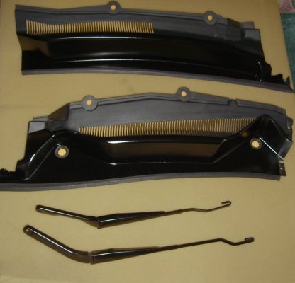

Painted that windshield stuff.....again. Last time I used a 1K clearcoat from Spraymaxx and it got cracks after 2 years. So I had to re paint ALL repair spots I used this can, that was fun. Used 2K now.
The gray part is unpainted in the engine bay and nearby new quality. The black is Dupli Color black.

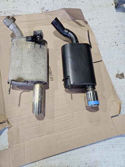

Then, I couldn't resist adding an axleback. Installed a Flowmaster 817410 kit. My '03 Cobra had 40 series Flowmasters, and I loved the "musclecar" rumble, but it droned badly in the 2,000 RPM range, so did some research and went with the updated Delta 60 series. LOVE it. Very deep/throaty at startup, with absolutely no drone, at any RPM. Loud enough to overshadow the JLT intake sounds at WOT, but not annoying. VERY happy.
