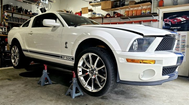

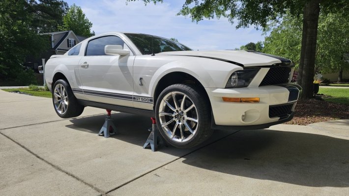

How stable is it, sitting up on 4x of those stands and how do you manage to get it up like that without rocking it off the far side?
It's solid. I have the Steeda jacking rails under it, the jack stands are basically about 2" inward from either end. I jack up the first side, stick the jacks under it, I jack up the second side and if I want to go higher, I go higher on the second side, then go back to the first side and level it off. I've had the car almost as high as the stands would go, made it easy when I was doing driveshaft swaps.
I do mine one front corner, opposite front corner and then jack under the rear diff to get the rear stands. Coming down is the reverse. It's a hassle.
That sounds so nice.. I need to invest in the rails, I put off a lot of jobs because it's a hassle getting it up on stands without them.

I had those Steeda rails on my old 06 GT convertible and they worked perfectly for jacking, support the car and even improved structural rigidity.
I currently have ladder style welded subframe connectors on my 05 GT and also use them to jack up and support the car.

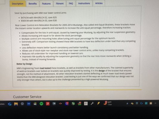

I did some of these brackets years ago when I lowered my car, and although I have yet to do it, I think at some point you will probably want to weld them on. I found out when I replaced my LCA's that those brackets are able to move around, I don't know how much it affects anything though if you aren't racing.
Maybe so............but according to MM welding these isn't recommended or needed (provided MM's description off web site below)..........car isn't intended to be competitively raced but is intended to be driven hard into winding twisties on occasion but retain current 13-14 GT500\08-09 Bullitt-stockish ride compliance thus I specifically chose these (a lot of road course tech easily transfers across & is useful in a daily driver that will see some spirited driving on occasion........) due to MM designed for OEM 05-14 S197 rear suspension geometry & OEM or aftermarket LCA use.........which no one else does (not even Ford Performance......) & is what I'm running........except none of my parts are OEM '09 MY........all are OEM later MY S197 SVT-derived GT500 parts except the UCA.....this is a Roush 3rd Link (Roush modified 07-09 OEM GT\GT500 part that retains the OEM 07-09 S197 UCA geometry).
As tight as these things interlock\mount onto the 8.8" existing LCA brackets w\ my parts usage.........I don't foresee an issue w\ loosening up but we'll find out over time.

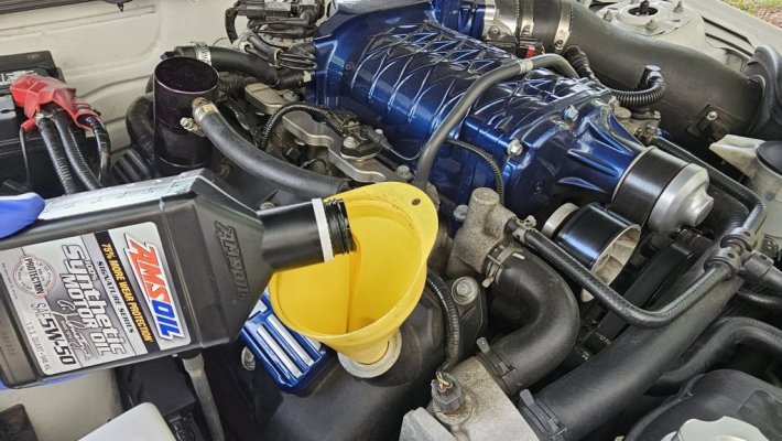

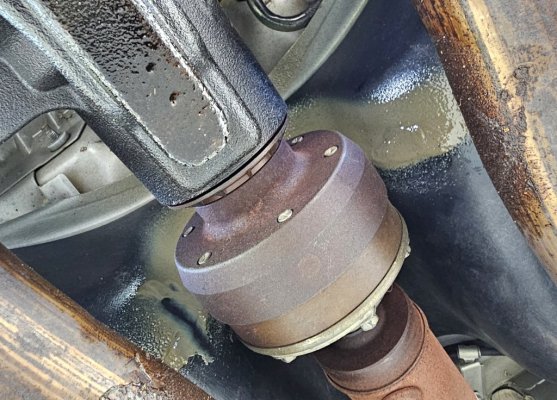

This weekend it was the wife's Shelby's turn for some attention.
Fresh Amsoil 5W50, new Motorcraft filter, a new sensor for the AEM oil pressure gauge, flushed the brake fluid, and gave it a general check over.
Found what seems to be grease slinging from the back of the DS, a couple/few inches ahead of the pinion seal. It doesn't smell like diff fluid. Was told it could be grease from inside the rear CV joint.
The bottom of the diff is wet, but the pinion seal area looks dry. Pulled the fill plug and fluid level is good.

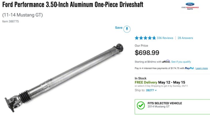

Thinking I need to find a good driveline shop to have the driveshaft repaired or maybe look for a low-mileage stock '08 GT500 driveshaft. A new Ford Performance 1-piece is not in the budget right now.

East coast gear in Louisburg….talk to Chase

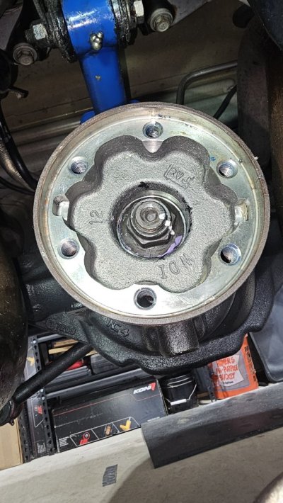

Replaced the factory driveshaft which had developed a leak in the rear CV boot with another factory driveshaft that came off a car that was bought and immediately sent off to Shelby American for the Super Snake package to be installed. The car had 8.3 miles on it when it was sent off, according to the owner. Part of the package was apparently a 1-piece Dynatech driveshaft.
Also fixed a diff fluid leak which had developed over time, seeping through the pinion nut. Took the nut off, cleaned it, put RTV sealant on the back side and put it back on with some Loctite on it. This was as recommended to me from a good friend of mine who works on these cars all the time and has seen this a bunch of times.
While I was under there, I also installed a new axle vent and topped off the diff fluid.
Planning on a finned aluminum cover soon along with fresh fluid of course.

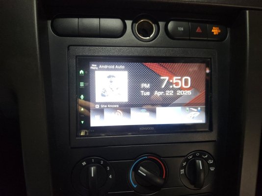

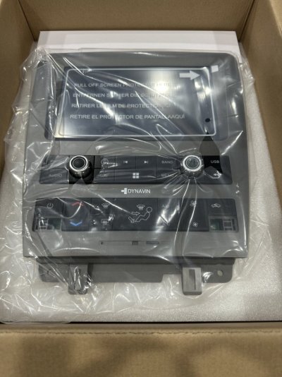

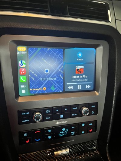

Installed the first part of the Stereo upgrades...the radio. DYNAVIN9! If you have the stock radio.....it is a MUST! It is SOOOOO nice to have an upgraded radio....feels like a new car!!! Now I just need to get the amp, mids and subs in! HAHAHA

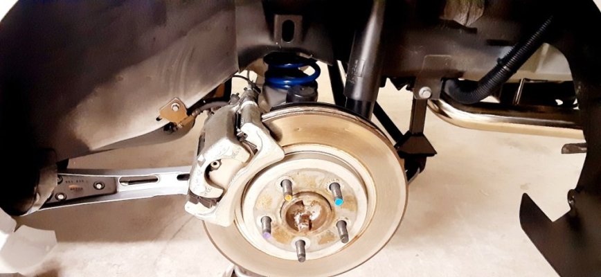

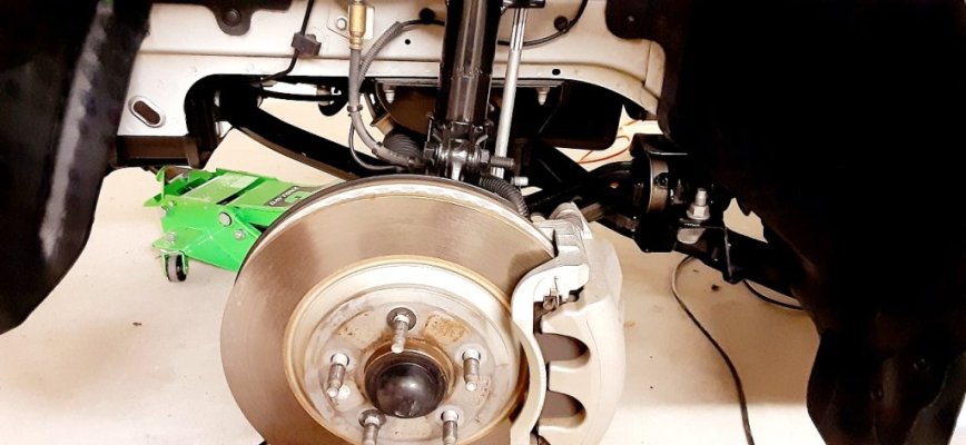

They mean you have to put the matching color lug nuts on the corresponding stud. duh.
I'm sure they are probably from the factory and have to do with the assembly process. I wouldn't worry about it. The look pretty though.
You can yank those little clip/washers out of there too (bottom pic). They install those at the factory to keep the rotors on as it moves down the assembly line. If you ever buy aftermarket wheels those little clips will keep them from seating properly.

Wow Your car still has those factory brake rotor clips…. How many miles do you have?
