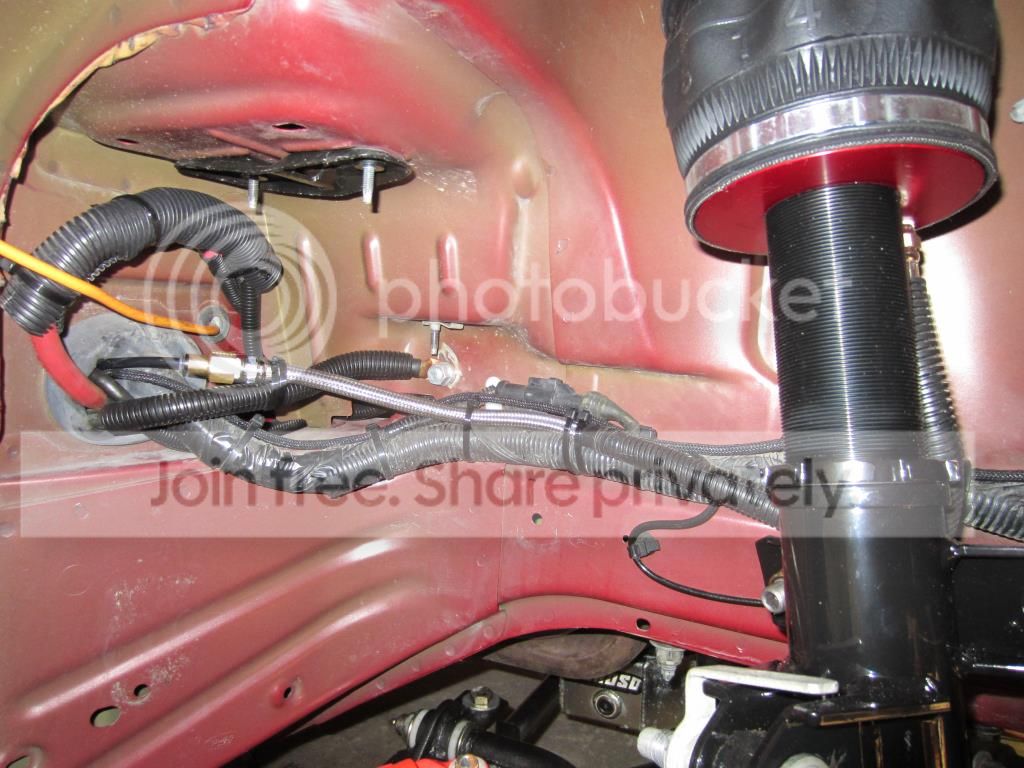

Scott, where did you ground the battery at?
Would this be a good spot to use as a ground in the trunk?
Sent from my iPhone using Tapatalk while Moonwalking
Actually I did not ground in the trunk. I ran a 1 gauge cable from the battery box to the OEM battery ground location in the engine compartment. You can see the location in this picture. I ran a 1 gauge positive cable to a junction point in the fender and a 4 gauge cable to the alternator. I used a 150 amp fuse on the alternator and a 200 amp fuse on the main positive cable.

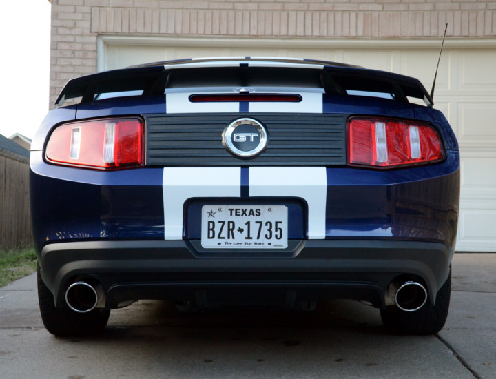

Big weekend - Hood struts, mufflers, gt500 valence
I hadn't planned on getting all this done, but the weather was too nice to not be outside having some fun with my Mustang friends. Borla S Types on there along with my GT500 valence. Also, there's a shot of my car trying to be cooler sitting next to my buddy's 2014 Super Snake.
