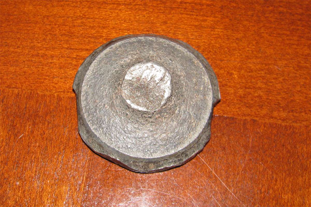

Here is one of mine from a previous stang... Valve spring broke, dropped the valve in to the cylinder, broke off valve stem, and shot the valve back through the hole it came from in the head. It really F'ed the head and piston up but gave me the opportunity take a 1973 2 barrel 351 Cleveland and turn it in to a .10 bored 4 barrel Boss 351 motor so in the end all was good.

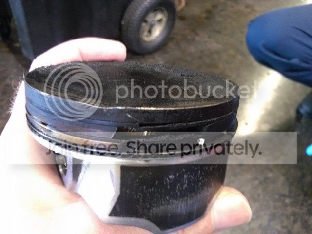

This is from my (former) Yamaha ski after its best top speed season. Ski ran perfect, compression was perfect. I only discovered this when I went in to re-ring it. Chunk must have blown out the exhaust. You can see where the ring hung in the exhaust port, pushed up on the ring land, which caused the middle ring land to break.
