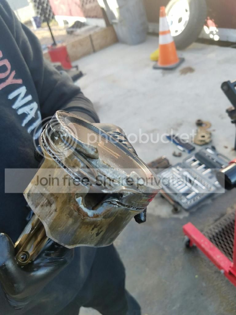

What did he hit to destroy the car like that?
Said he was only around 700 HP, surprised it let go that early, he said.
Still can't believe he walked away unhurt.

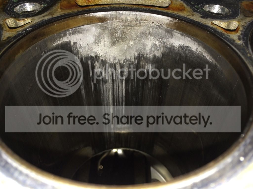

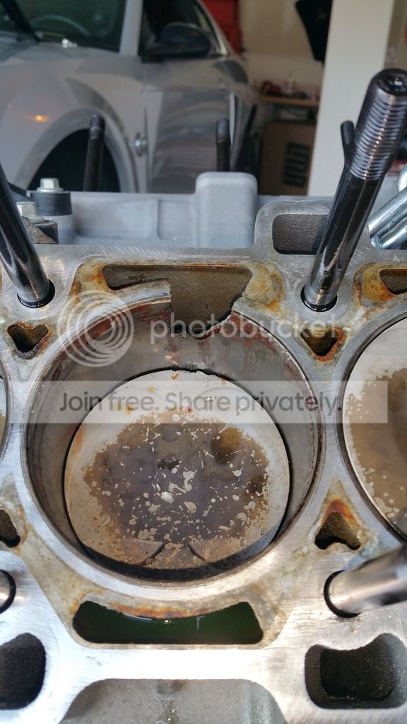

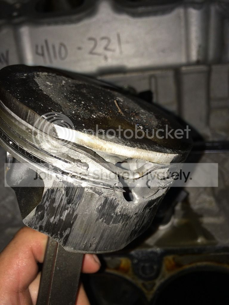

that's a tune or fuel failure, IMHO, not power output
03 cobra...owner not sure what happened.
It popped. That's what happened.

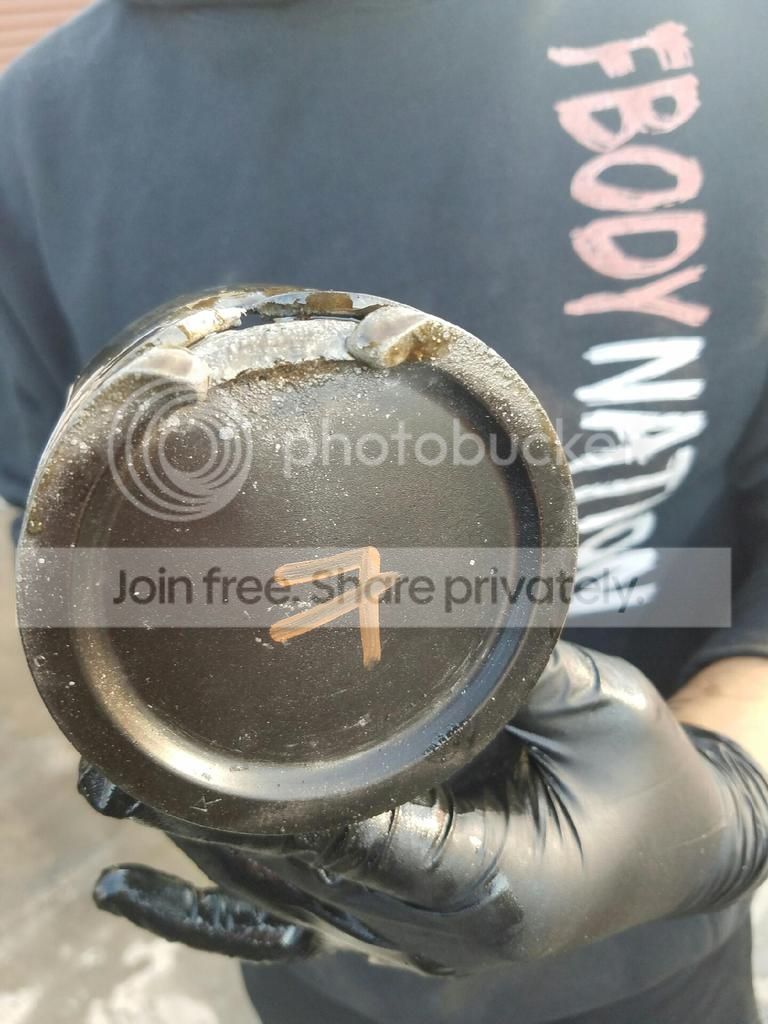

Did the clip holding the con rod to the piston fail?
I was thinking massive detonation with broken ring lands and then driving with a broken piston. How they couldn't hear it?
