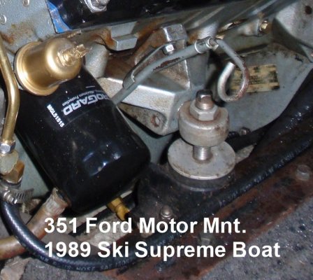

For what it's worth........
Here is a photo of a 351 Ford V8 motor on a 1989 Ski Supreme boat.
The mounts are fully adjustable, including the angle.
