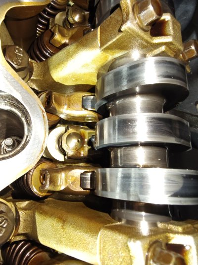

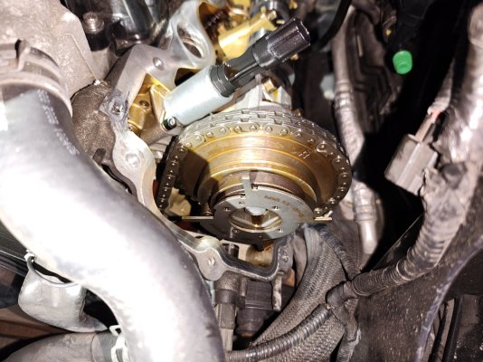

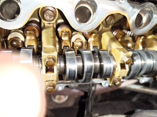

so i unplugged purge valve got no codes, noise still happened i drove car just a little short distance, came back and then opened hood immediately and was just touching my hands around to see if i could feel any reverb out of curiousity and i felt one on the vct solenoid each time the noise happened i felt it not sure what that could indicate but it seems like its pointing in a direction.
I'll be pulling off the cover this week end but just figured ide feel around again to see if it is anything obvious i didnt unplug the VCT because i worried that it might cause some strange engine running but it seems like it might be linked to the issue.
Moccubus
Jun 14, 2026
37
9
Maryland Heights Missouri

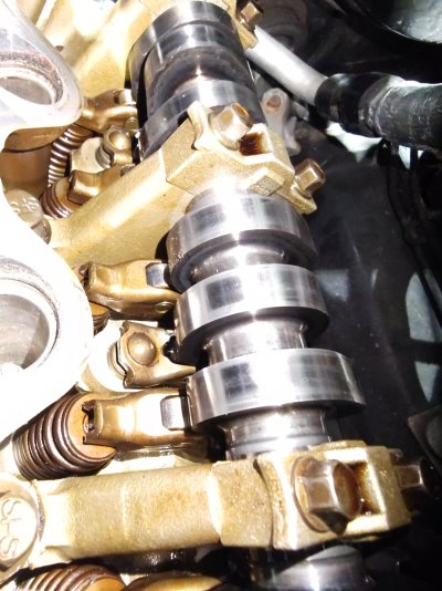

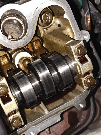

Don't understand cams look ok to me, felt the lobes didn't feel anything out of place. Ideas ? I checked the rockers nothing felt like it was not functioning properly. I might try running it tomorrow with the cover off to check.

If you have a rocker bearing going out, you won't be able to feel it without taking them out and spinning the bearings.

I'm thinking it has to be a rocker bearing nothing else could randomly make a noise like what I hear I feel but at the same time. Why would it pop when it's cooling off. Either way, need to diagnose it before it causes any actual damage.

The engine off .. no way it's a roller follower ..
It makes no sense how it could click when the engine isn't on?
Unless the pressure of the cam lobe pressing the roller follower makes it kick or move once the compression bleed off some?
I'd still remove the valve covers just to be sure u won't destroy the engine . But it seems odd it does it with the engine off ..
To be safe id remove the valve covers and hand crank the engine and just make sure the roller followers are sitting still and nothing is amiss

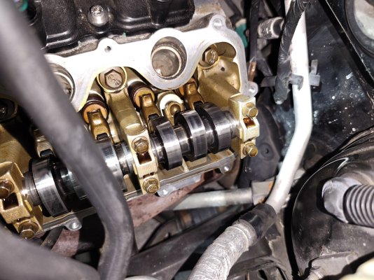

LOL I have fluid build up in my ears at times and I thought the engine was running in that video :Big Laugh: Sorry for the error.

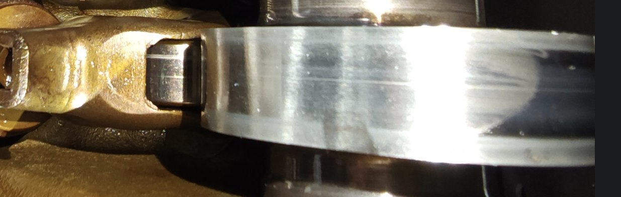

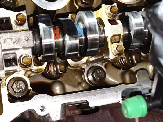

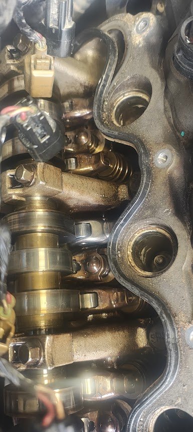

Looking at them photos, is that metal particles on the cam on photo 4 from the top? On photo 5 the top roller in the photo looks like the polished surface has gone on it? I had one the same and noticed it while stripping the engine for another reason. I just got it in time before it started marking the cam lobe. i have a picture of it some where and will post it if i can find it.
Kev555
Dec 12, 2021
425
205
Ireland
You see the slight marking starting on the cam where the new roller is fitted but this roller was not making any noises yet and felt only very slightly rougher turning than the new roller.

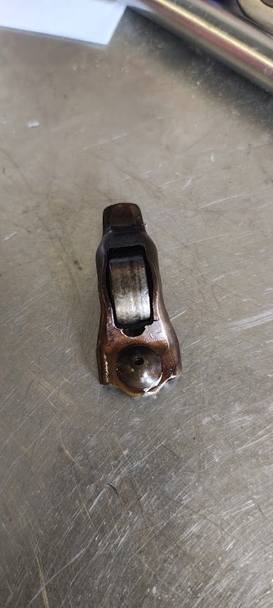

View attachment 117291View attachment 117292

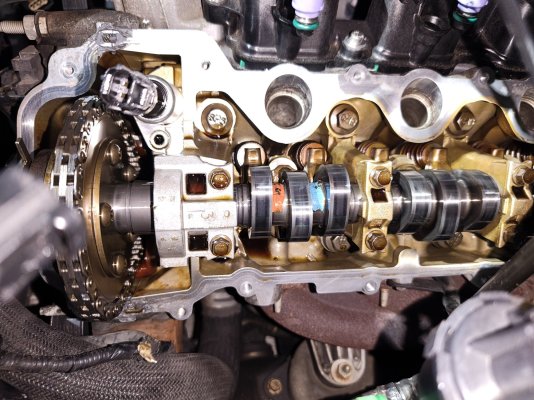

I might just do them all to be sure while i have it apart. this is what i noticed so far the roller looks like it has a worn mark on it.
