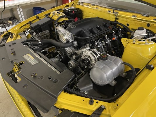

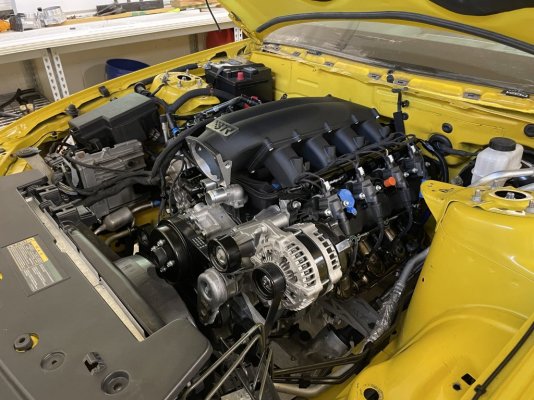

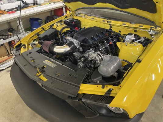

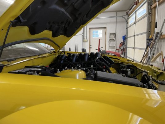

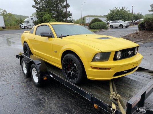

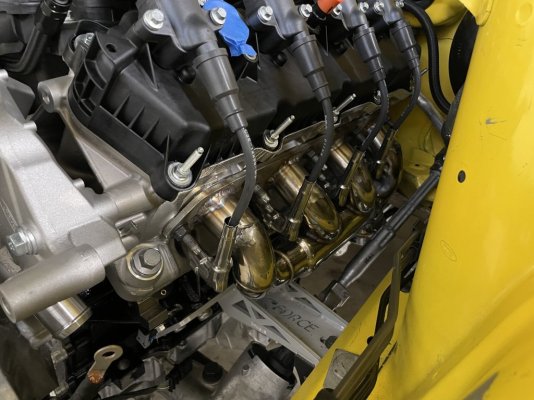

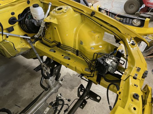

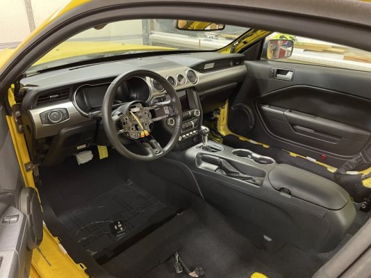

So new guy intro here… For the past year I have been working on brining an 06 GT back to life. I bought the car complete but with no drivetrain.

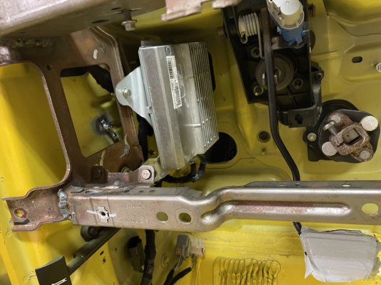

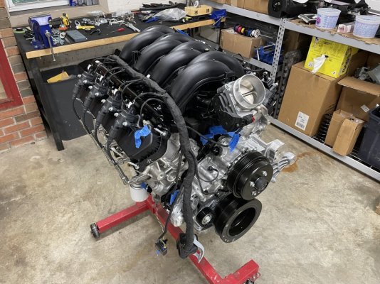

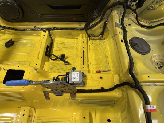

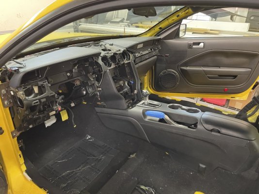

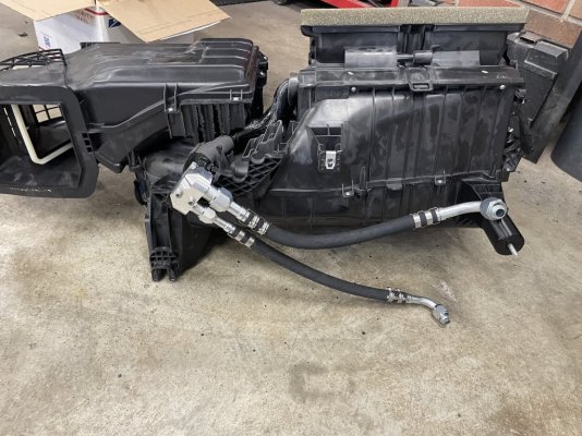

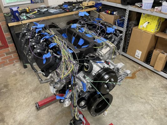

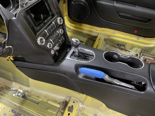

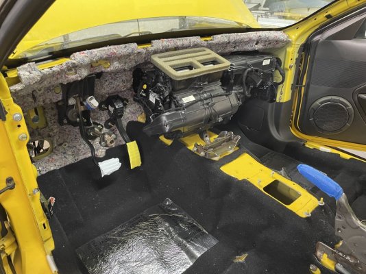

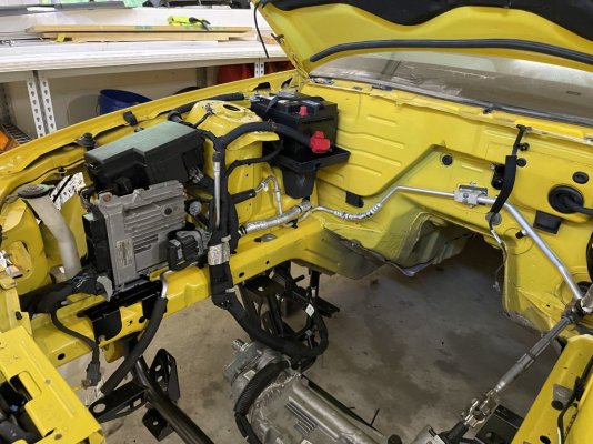

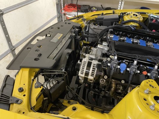

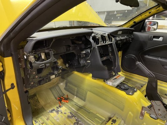

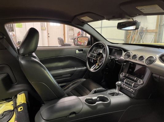

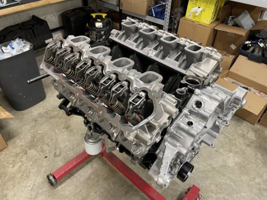

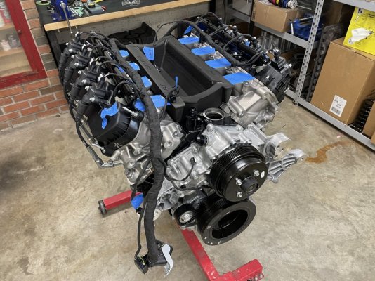

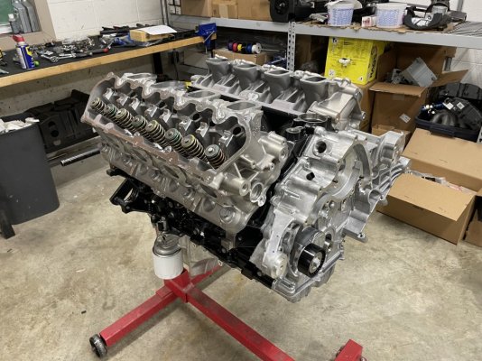

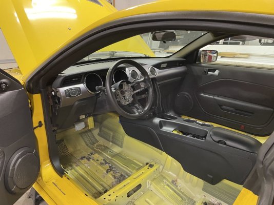

What started out though as a simple coyote swap turned into a complete gut and re-wire. The car now has a full 2017 S550 interior including a 2019 LCD cluster and dual zone HVAC. The drivetrain is a 7.3 Godzilla/10r80 combo powered by a Gen 3 (18+) coyote PCM wired into a 2017 electrical system.
Currently working through the tune and preping for paint!
