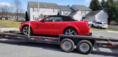

I decided to take the plunge and buy a salvage title car (relatively minor damage) and repair it.
I'm documenting the whole build on my YouTube channel.
I figure I would go to the knowledgable people and ask questions as they come up.
My first question is: the power steering reservoir was broken in the accident and the fluid came out. When I took delivery of the car, it drove but it clearly has no power steering.
I bought a new power steering reservoir but if the car was driven for a few minutes with no power steering fluid, will adding fluid fix it or so I need to replace more?

Luckily for me, the frame did not take damage.
It was really only the radiator support that was dented in.
As for replacement parts, I ordered 95% of what I need and I am completing the disassembly now.
Should have that video up shortly and then I will begin the rebuild.
