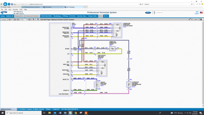

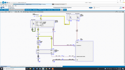

IIRC, there is no low pressure switch on 11-14s. So you must be talking about the high pressure switch on the compressor discharge line. Going from memory, the 3 wires are: 5v, signal ground, and signal return. So no power at that sensor might be the pcm.

I would scan for codes and check circuits involved for continuity before buying parts.

I haven’t bothered to look over the schematic on my phone but if you jump that relay do you then have power at the pressure switch? If the relay is what powers that switch then work back towards what kicks that relay on. If the switch is a required input to kick on the relay then work from the switch back and see where you’re losing your power.
