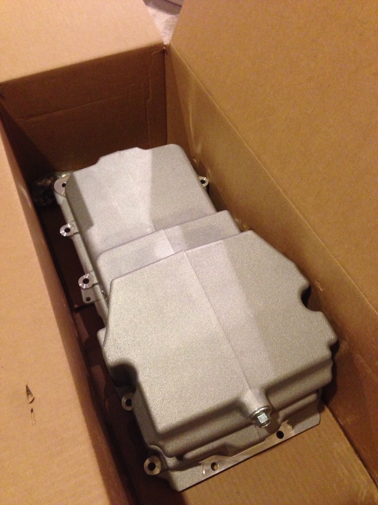

2013 GT500 cast aluminum oil pan 8.5 quart

I got mine from my fiancé for my birthday. Definitely a solid piece. I also think you have to tap for that oil sensor since there's no hole for it.

You have to trim the windage tray a little where the front studs come up I believe.
Skwerl has a pic of the trimming in post #1 of this thread.
I would round the inside corners off a bit more, though.
Squared corners tend to crack/break.

No, this is a windage tray. So pick one, not both.
What I meant was can I use a stock windage tray with this pan.
As it has a seperate gasket.
And it appears that the new windage tray is a one piece deal gasket and all.
I'm going to assume yes I can.

I have no idea how to gauge performance of a windage tray, but my car has been running fine for about 2K miles with it. All other questions that I can answer were answered in the first post of the thread (with pictures). The new pickup tube appears identical to the old, stock pickup tube but I used the new one just because it was there. "Identical" means exactly the same with the same mounting points, same depth and same fitment. The new tube has a new rubber o ring where it bolts to the oil pump.
Sorry, yes you can.
BruceH
BBB Big Bore Boss 322
Sep 13, 2009
13,801
14
Pacific Northwest
Unless you use the 5802 arp studs that I'm using. They don't have provision for stock windage tray
Since I used mine with a boss block there weren't any studs in the way either. In fact that's why I went with this setup. So that I didn't have to take the main bolts out and replace them with a 3v version for a windage tray.
Hamish, This setup is for a 5.8 which has longer stroke than your 3.8". It should work fine.

why in the hell would you want the stock windage with a separate gasket? I mean, for one you don't know that a stock 3v gasket will seal this pan and 2, the gasket/scraper for this pan is only 68 bucks. It makes no sense to me to go backwards but to each their own
skwerl
tree hugger
Aug 6, 2011
16,199
1,147
central Florida
The gasket/windage tray is included with the pan. So is the pickup tube and pan bolts. You even get 4 extra pan bolts (but you don't get the bolts to attach the pickup tube).
BruceH
Sep 13, 2009
13,801
14
Pacific Northwest
Those parts come in the frpp kit. The pan can be purchased separately. IMO the price for the whole kit is well worth it. I don't think you can buy any aftermarket oil pan for less than the whole frpp kit. Plus it has the kick ass scraper/windage tray.
