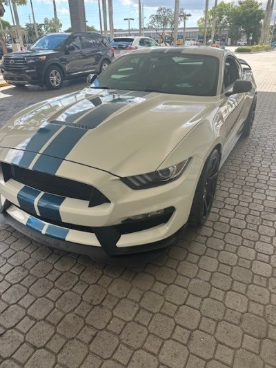

I have a beautiful Shelby 350R here with some very tasteful mods for a Warranty Engine Replacement. Pushed a little hard on the road course and has an oil consumption issue now. Uses 1 Quart in 65 miles. That's alot! Happens to be Wimbledon White with Blue stripe package as well.

Stock engine? What in the world happened to make the engine pop? I’m assuming the oil consumption is from a broken piston?

It is. Customer admitted that he “pushed” it too hard. We don’t know specifically what failed. Ford does not ask us for internal diagnosis
