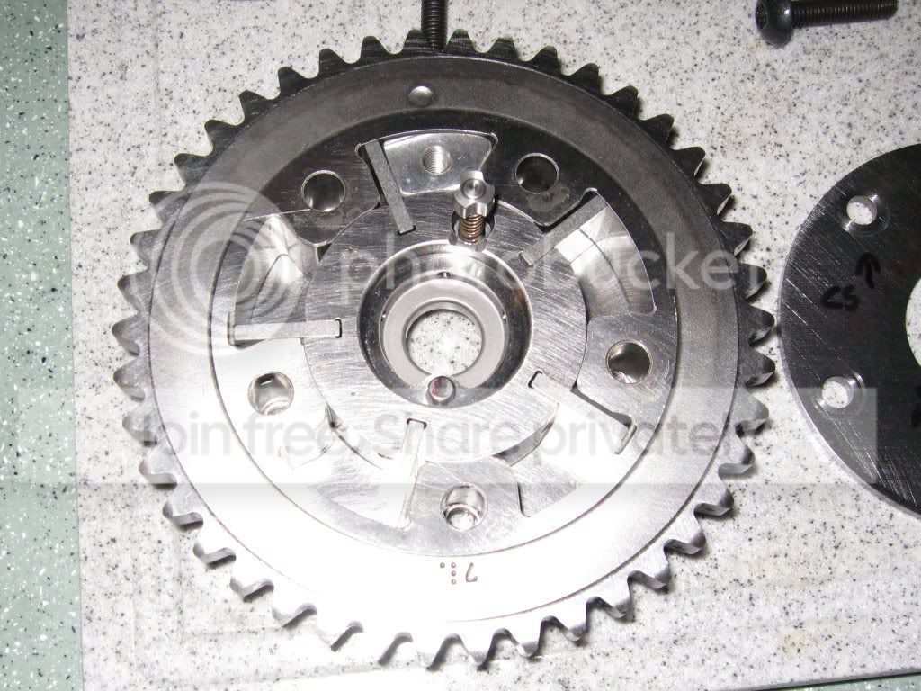

You will get better RPM out of the Cams retarded instead of advanced.

The 550,s are locked full advanced.
I have never seen anyone set them up full advance. Are you sure you don't have the terminology flipped in your head?
Retarded cam timing=more top end
Advanced cam timing=more bottom end
I'm not even sure the pistons would clear the valves at full advance???
I think he has them retarded
What do you mean by "better"rpm?
Retarding the cam timing moves the curve to the right of the dyno graph.

Hopefully I won't get flamed but BBR. They were the only quickly available ones when I built my first engine.
It's all a matter of the position of the cam gear sprocket when they are installed but I'm sure you know that. When my current engine was built we checked the cam timing and it was within one degree of comp's recommended so no changes were made. I think it all has to do with how the cam has been ground and my 127300's seemed to work fine at full advance.

Advanced. Here is a pic of the PS cam and lock out. It is a bad pic so I will see if I can find a better one but take a look.
