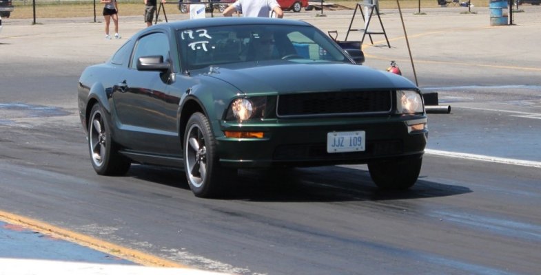

I haven't been down the 1/4 mile in forever but my Bullitt is mildly modded BBK UDP, Kooks LT with Catted H-pipe, 110 JLT CAI, HR Cams, UPR Tubular LCA's Hurst Shifter and I did 13.23 @ 112mph with Nitto 555 G2's. (No power shifting) I'm sure I could hit the 12's with the Indy 500's (255/45/18) the grip just feels so much better. So someone who really knows how to drive could easily do low 12's in my very rookie mindset.

I must admit a very well prepped track surface never hurts :peace:

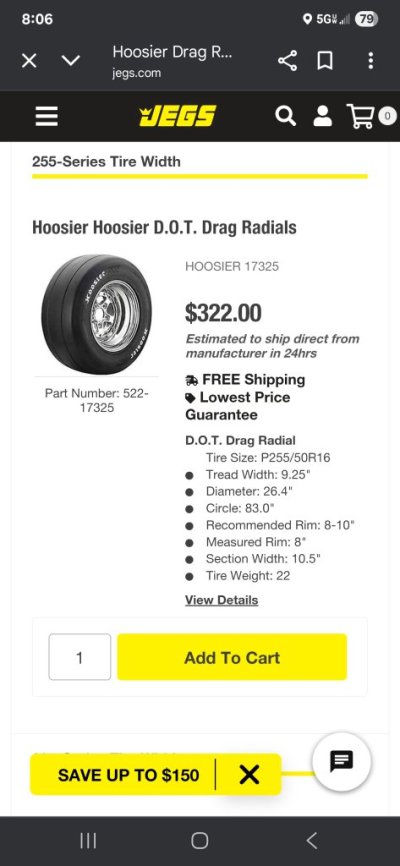

You'll be pulling a tire soon. Lol on the Suzuki. Bikes are a bitch. Get a good shifter. It is night and day better than the stock shifter. I'm assuming you still have the tremec 3650 with stock shifter. Are do you have the MGK? IDR. Anyway, I was running a small drag radial:
Tiny things. And they have doubled in price in two years. Jeez.

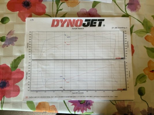

Not a great deal of dyno time but here is one of my favorites. Shows 498 torque at 3600 rpm and hits 500 hp around 5800 rpm. I think it peeked at 515 hp. I have another chart or two similar that show torque peek a little lower. Heat soak I think. This tune is from Lito and drives very well. I have another from Brenspeed that drives well also but makes less power.

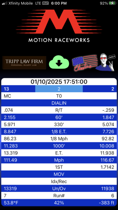

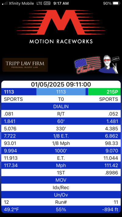

The car has run 11.9x on two occasions (very low DA), so with the additional mods that you suggested, I'm sure you could achieve 11.xx ETs on a fairly regular basis. I have attached a couple of slips from Bradenton Motorsports Park in Florida. Car number 1113 (my bracket number) and car number 2 (track assigned at T&T). As also mentioned in this thread, weight reduction included removing the passenger and back seats, empty trunk, and less than a 1/4 tank of fuel. Full weight, these times would be 1.5-2 tenths higher.
